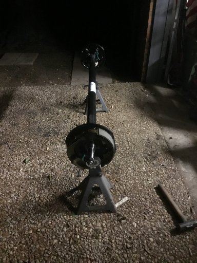

After a run in with a flash flood and having to do a untimely river extraction on some of the members of our party on our last outing a change is in order. I have decided that my truck will no longer be set up as base camp. Had a pretty some close calls that I wasn't set up for and I don't like that.
Off-road Trailer build is happening!
Trailer build list to Keep me on track.

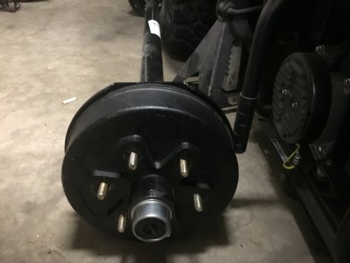

3500# 6x5.5" lug pattern axle
(6/15/17 picked up.)

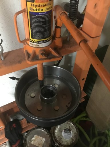

(6/19/17 Changed studs in trailer hubs to same thread as truck: Dorman 610-384)
(6/19/17 assembled wheel hubs on axle)

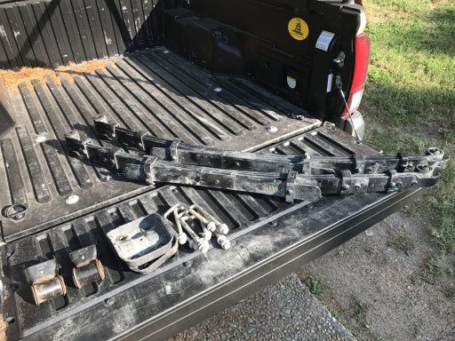

Tacoma suspension
(6/23/17 shackles received)
(6/25/17 Tacoma springs, u-bolt plates and u-bolts picked up)

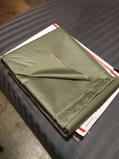

(6/17/17 ordered 10yards tan 70d 2oz ripstop )
(6/19/17made arrangements with http://www.ohenrytents.com/ For awning build)
(6/23/17 canopy material is on site.)

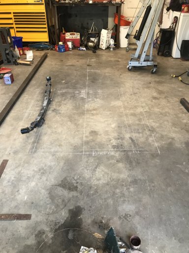

Well the garage is cleaned and I got all my measurements laid out today. I think that is a good place to stop for the day. Now it's taco time.

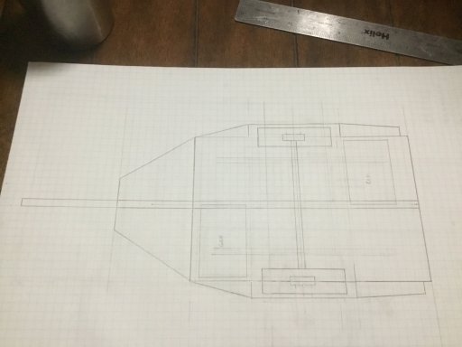

Ok I finally set down today and drew up some rough plans on my trailer. Up until now they have just been bouncing around in my head. I'll take these and get with my buddy with the plasma table and get the .dxf files drawn up and hopefully I'll get to get some more done on it. Today I'm down with my on going neck problems so that has put a damper on things. Might have over done it yesterday.
Still try to decide if I want to skin it in riveted smooth aluminum or welded light gauge steel. What do y'all think.IMG_0140.JPGIMG_0141.JPG

Usually id say aluminum. But steel in this case. All those rivets would have to be sealed with silicone or something else. I had a few riveted things on my trailer for its first run that leaked a little. Now everything is bolted and sealed.
Wats your plans the back-end? Hinged door? Tailgate door?
Yeah I'm with you on the rivets and sealing them. I'll probably wind up with welded steel on every thing.
Rear will be a hinged door. Not fond of the drop down gate.

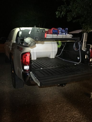

Yeah the water weight has become a norm for camping for us. We spend 7-12 days 60+ miles down Padre Island 2-3 times a year. It's along drive out at 25 mph to get more fresh water. I am actually dropping my capacity for the trailer build. I won't always fill the tank to capacity. I have always run a large tank and just filled it according to where I am going. Sometimes I just use aquatainers all depends on where when and how many people are in our group. I typically haul 65 gallons for our beach trips. The weight isn't that bad and keeps the wife happy that she can shower off any time she wishes... So I'm good with it.
Old fresh water setup 65 gallon poly tank with surflo on demand 12v pump. IMG_2324.JPG
