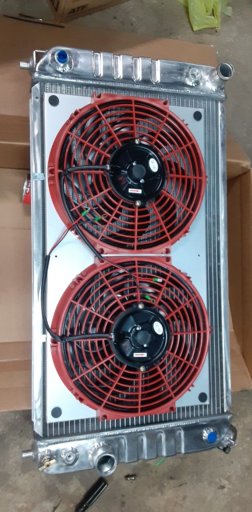

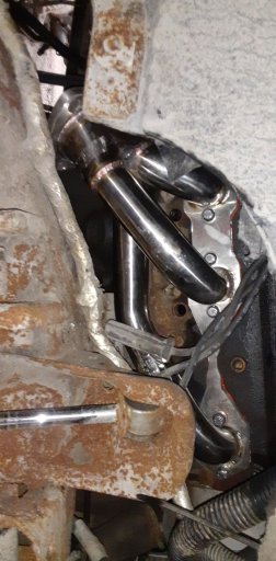

Ok update transmission went out on the old s10 so I finished the rebuild it is back in and just have to finish up a few things on that side of it also while it was out put on all new u joints put on a set of headers deleted the old fan off the water pump and put in a 3 row radiator and electric fans on a thermostat working on putting in new billet distributor high output coil 8.5 mm wires and e3 plugs and put a new set of 31 all terrains on my new beed locks I still need to put on my new exhaust and the camper shell I have for it and she will be ready to roll Snapchat-1108514211.jpg

It is becoming that after the Pearl siting for so long, I will be having to slowly replace several systems, a little bit at a time. Currently I am putting together two separate parts list and would greatly appreciate what specific parts you would suggest. What's worth the money, will stand up, and actually do the job. Figure if the parts have to be changed, its the best time to upgrade. But it looks like I will only be able to do one of the two options bellow.
When they straightened the frame, they cracked the radiator. So no it has a bottle of Bars Leak in it, along with an amazing amount of rust.
Ideally the radiator is going to be upgraded to a high capacity full aluminum one. I like the one in you photo above but am not sure where to get it. And the ones I have looked at, I am not sure they will fit properly.
The clutch fan is going to be replaced by a dual electric fan system. If possible, with two speed or variable speed fans with controls located in the cab. I already know what components that will be needed to run the controls to the cab. At this point the current parts list includes
