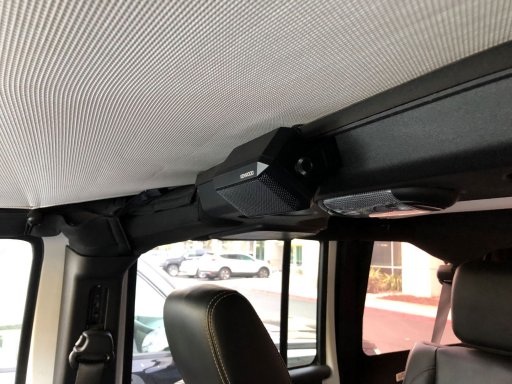

Oof, I didn't know that they made all of these. Now you are going to make me spend money. Also seeing those pictures on their website and amazon has made me realize that my speaker bar in in there backwards. As a 6' 1" man I occasionally hit my head on it. I'll have to flip it around to put that in.

I attached my remote speaker to the center cross bar. It doesn't block the rear view mirror and is easily heard, especially in a soft top.
