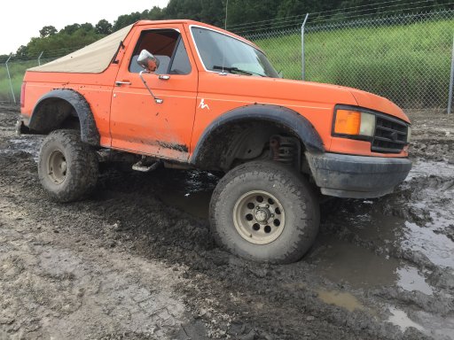

The truck stands on 35 inch BF goodies, I'm pretty sure the PO put on a 4 inch lift but it could be a 6. the fenders were cut to accommodate these crazy fender flares. (not my favorite addition from the PO)IMG_0764.JPG
So here's where I could use the advice, How hard is it to take off the lift kit and go back to stock? in an ideal world the fenders wouldn't have been cut and Id lower it and put on 33s. but since they are cut i think i'll have to stick with 35s so it doesn't look like it has tiny tires. which it kind of looks that way now.
I also think it needs to be re geared. its a 4 speed automatic with the 5.0 in it. the rolling hills on the interstate or big hills on the highway make it shift from overdrive and 3rd a lot. i understand that is an expensive job (quotes from 2k to 3k). So i'd like to reduce the lift and see how the driveshaft angle effects it.
When it comes to steering the truck is all over the place. I've done research and i believe this has to do with the camber? once you lift it high enough it has too much of a vertical angle to allow for tighter steering. yet another reason to remove the lift. I would also like advice on how a less aggressive tire may effect overall handling and power band driving at highway speeds. Do they make a 35x10.50 tire?
I would love to build bumpers for the truck and do some kind of winch in the future as well as a sweet tire carrier/gas can rack on the back. if anyone has any shop drawings on that i have a welder i'd like to take a swing at it.

if done right the lift should not affect the driveability at all , check to make sure all your steering bits are in good shape , all your radius arm bushings are in good shape also . Any slop will cause it to wander all over the place . Take some pictures of the suspension components and the radius arm brackets and post them up so we can see what your working with

The problems you described are typically for lifted solid axle without correction and or no corrections on the steering (drag link flip or something similar)
So I would get much lower lift 2" or so with all components needed to get a proper alignment.
Look at the 285 metric tires its somewhere around 11"width.
I have 285/70r17 on my wrangler jku and it works just fine, it's about 1/2" smaller and 1 1/2" narrower than 33x12.5, better mpg

I agree with @MazeVX. Replace the lift with something in the 2inch range. You may still find many of the steering components have worn parts that may need replacing.
You can never go wrong with regearing. Your axle should have a label showing the OEM gears. Lots of on line calculators to provide guidance on the best ratio for after market tire size.
