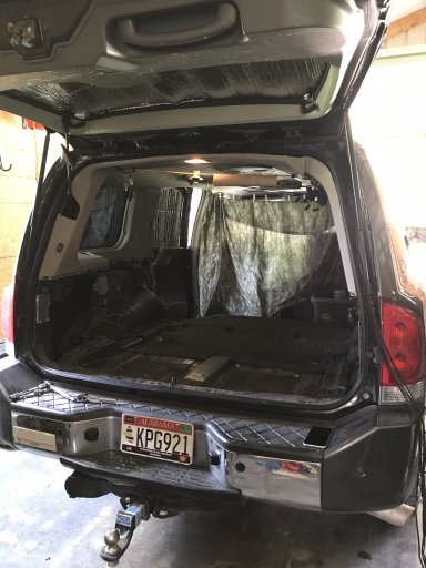

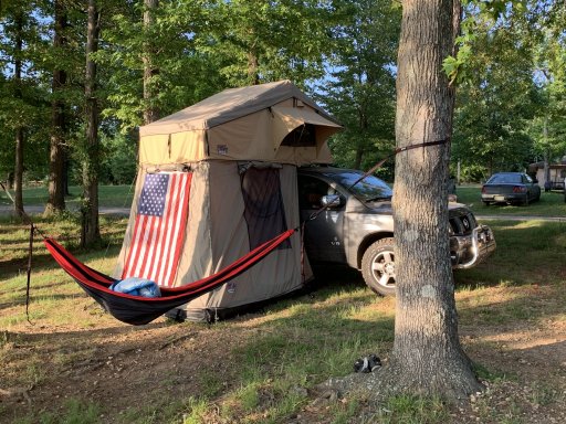

Got my 2005 Nissan Armada stock a few months ago and I live in it full time now. Build as I go I always have plans and wants and needs but time and money is key. So far been a great rig and has takin me where I need. So far I have put on :
Bf goodwrench 275/18’s
Pro 4 x decals
Tuff stuff RTT
Bull bar with lights
Secondary sleeping option inside and of course my living gear IMG_1441.JPGIMG_1034.JPGIMG_1033.JPGIMG_0975.JPGIMG_0982.JPGIMG_0945.JPG
