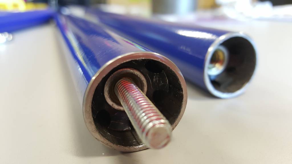

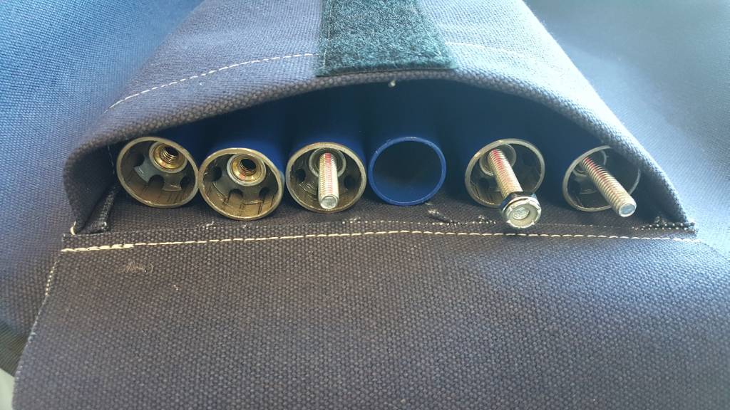

At this year's NW Overland Rally I bought my TT cooking apparatus and instantly wondered how to carry it. I saw a couple options, but the dual bag system was not what I wanted, so as a bag maker, I set out to make my own. First step was to address the legs - they are too long and don't fit in one bag, so here was my thought: cut them in half so they are smaller than the diameter of the cook surface. I did this on a bansaw easily and deburred the edges. Next, I found some 1" diameter star inserts on McMaster (1/4-20 thread) and ordered those. Pick up 3ea 1/4-20 x 3" allthread as well. The star inserts slide in easy (make sure to press them in evenly so your studs are straight) and place them about 3/8" inside. This will allow you to lock one side of the allthread using a jam nut against the star insert so the all thread doesn't spin. It will work without a jam nut too, however, you will just need to pay attention if you are using it a lot so you don't lose the allthread.
Super easy mod that allows the legs to break down further and fit into a singular bag.

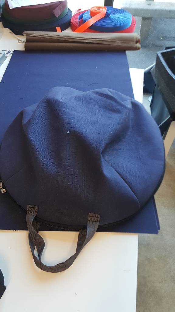

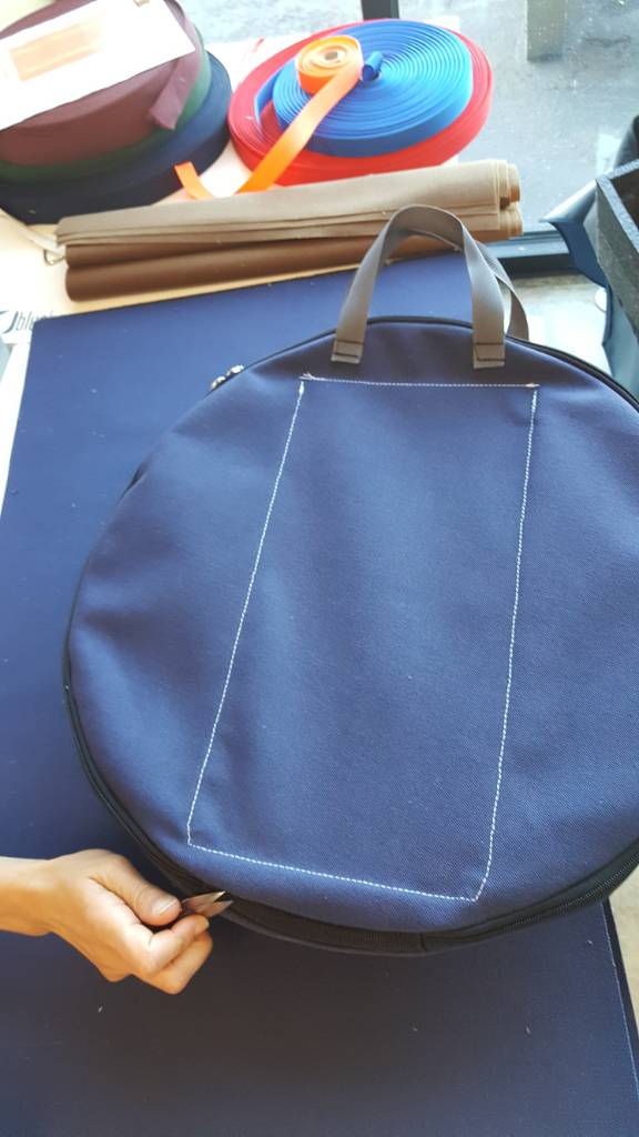

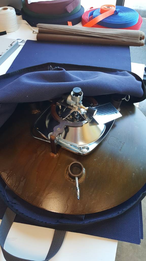

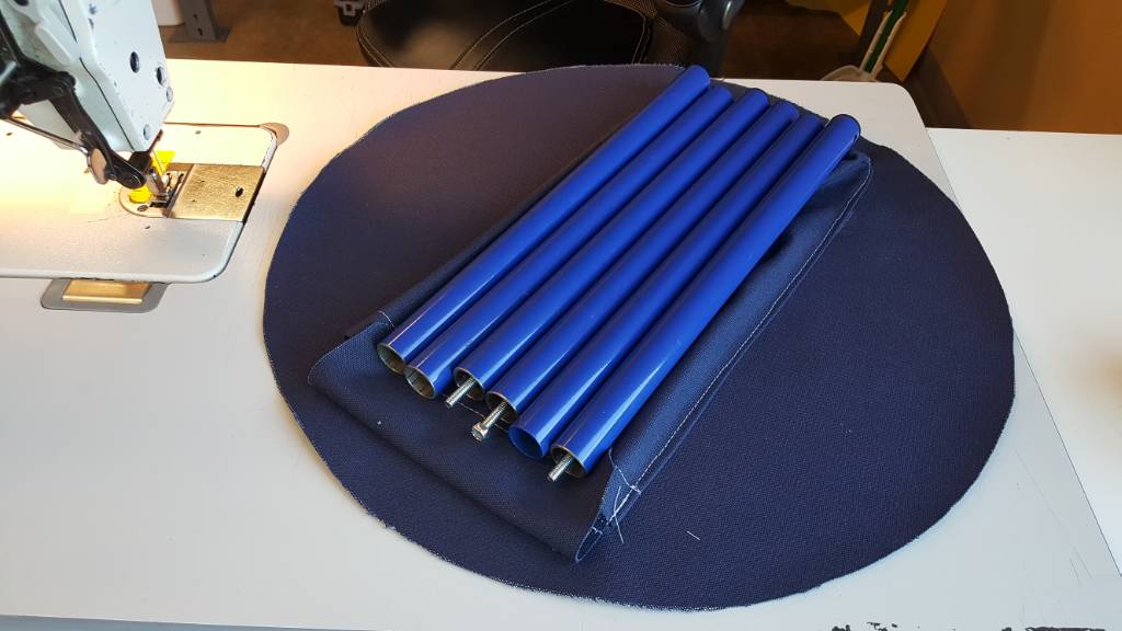

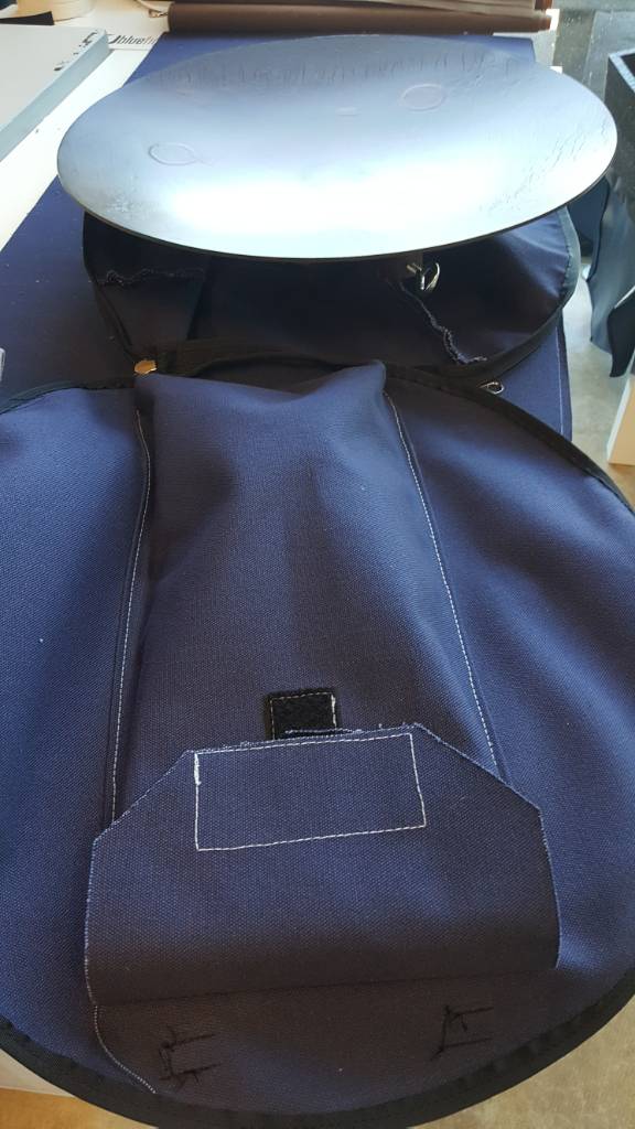

I addressed the bag next. Adam at Step 22 has a cool version that is nice, but still, legs ain't fittin'. I created the pattern to fit the burner as well (I have a cheap Century propane thingy) and built a pocket to receive all 6 pieces of the legs. The proto is done (images below) but I will refine it next week after and overland trip to central Oregon and make it look pro. Here are the pics of the prototype:
If anyone wants the pattern for the bag DM me and I can send as a dxf or .ai file.
