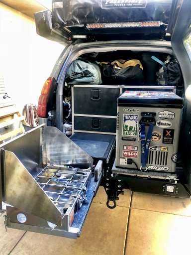

The response of the drawer has been overwhelming. I hope that it is a good starting point for your DIY projects. I know some may not be up for that kind of project so I’m considering starting a gear company. This is a simple website as a feeler.

Materials parts and everything about $1800. Aluminum isn’t cheap and the sliders are about $200 for a pair. It can be built for less for sure by using square extrusions and butting the joints instead of corner connectors. Just depends on what you are going for. I was trying to make something functional and cool looking, but 8020 offers a number of options

Amazing build. Did you need to make any other modifications to the 9722? Jets as delivered work well? Blue even flame with Propane?
It works great. I had to change out the regulator as it was an England butane unit. A Mr Heater unit is $11, and gives the right pressure. The burners aren’t huge so don’t expect backyard bbq

So no Thanksgiving turkey roast then? Appreciate the response. The documentation from Dometic pretty weak so it's great to get a confirmation from someone who is actually using it.

Yeah it boils water and will cook steaks, what’s funny is usually outdoor gear is easy to blast food and burn it, harder to simmer. This unit simmers great but is a little slower than my old Coleman stove. But my last 2 Overland trips have been at 9500’ which affects things as well
