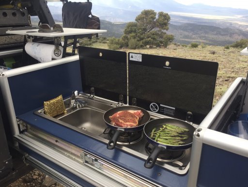

Hey @PapaDave , I am designing a similar slide out kitchen for the back of my 80 series.
I just received my 9722L from ebay. The cooking area is a lot smaller than I had imagined!
Do you find pot and pan space an issue? I'm thinking of when I cook for the family, not just myself.
thanks,
Andrew

I use 8” pans and the mini griddle from cook partner, fits great.

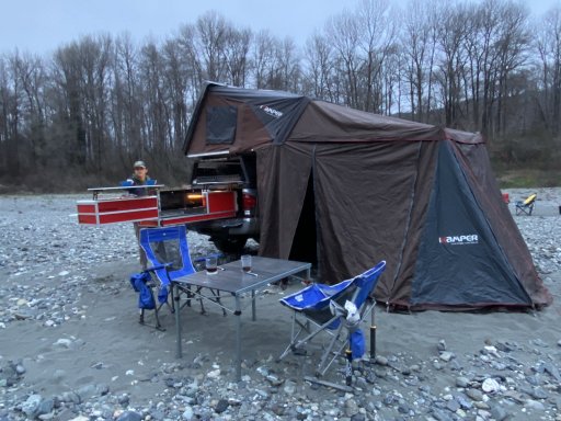

New floating drawer design with hidden slides. Big red :)
Self contained water and power
Even teenagers like to cook with it
View attachment 140620View attachment 140621
Hi Dave, thanks for the inspiration! My 9722 is arriving today and collecting all the other parts to start my trailer rig. That looks like a rotopax water jug on "Big Red" making it totally self contained and I'm sure keeps the water lines from dragging as you pull it in and out from the original design. Did you use a rotopax mount to the aluminum or a custom mount? Thanks again for sharing!

Good eyes, yes we used a standard non-locking rotopax mount
Be sure to share some photos of your build!
