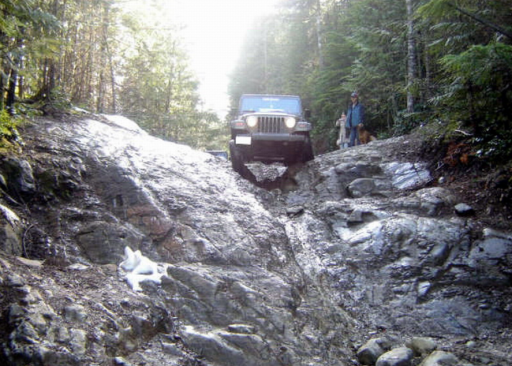

It is capable, but not for the tracks I intend to run. The good stuff isn't always down an FSR (for example the image below) and neither are some of the hiking trailheads with the washouts they get. Having done the same stuff in my Jeep, it's already apparent that while the stock truck may handle it, it won't be idea. Also, long drives on washed out roads and the like, it would be nice to better cooling capacity on the shocks for safety reasons.

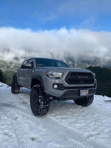

After waiting for all the parts (months), and finally getting all the cutting done to get rid of 99% of the rub with 35" tires on 3" of lift, here is the result. Thanks for the suggestions everyone.
Suspension: Bilstein 6112 & 5160 remote reservoirs with SPC UCAs and icon add a leaf
Wheels: Procomp 4" backspace, -12 offset
Tires: 315 75R16 BFG KO2s
