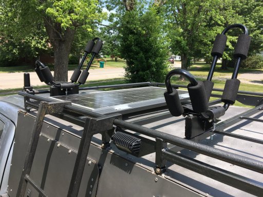

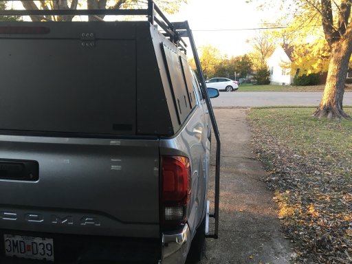

Then there was the kayak. No problem right? Holy kayak crap batman. This was a pain in my ass. Picked up some brackets because I can't bend 1" tube for less than $400. LOL. So for $45 I get the brackets, did the modification and mounted them on the roof rack. A little tight because of the solar panel, but it fit. Only problem was when the kayak was up there, it cut power to the panel...ahahahahahhahahaha. Design error No. 933a. LOL
Also built the ladder to get up there and tie it all down.
So this little thing was a champ. It was just a guide "V" to get the kayak up there with the brackets. This was the second try at this. First one was a dumbass attempt with rollers....lmao. It was bad, really bad.
Even welded in a tube for our Flag. MERICA....
