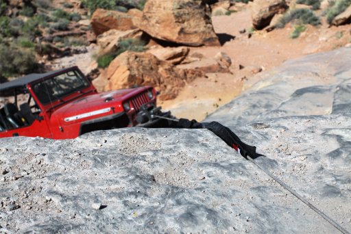

Just going to say, that how often do you really think you'd be winching over a rock where the line would be directly on a rock? Probably never. Done several dozen recoveries in Moab at od angles and our lines never touched a rock. Usually, your line is off the ground. I hear the comment about synthetic and rocks all the time. But I don't think anyone who says that, has thought about what the chances are of it ever happening.
I agree with @BoldAdventure, that its not common that you need to winch over rocks. Not to say it doesn't happen.
Use a rock guard, and call it good.

Good winch lines will have a heat shield on the beginning of your line to protect the first wrap on the drum from melting. My Master Pull Superline XD has been on my rig for seven years with no issues. I use it a lot, more at home on my 10 acres then on the trail, but both. Master Pull makes a rock guard, it is a 3ft canvas with Velcro cover that can go anywhere on your line to protect it from a rock or the ground.
