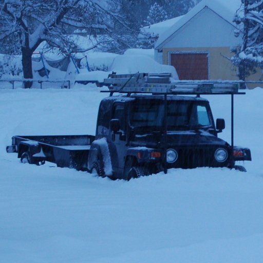

winter tires, not stuck, I stopped for the pic, backed up and continued on. winter tires rule
check out that tread pattern, winter tire rubber is softer too
a typical january morning
nothing wrong with the old KOs but winter tires blow them away
and I agree with rumble dog... these old KOs lasted forever. I still use the 20 year old spare as a spare lol
the wife letting us know how short she is

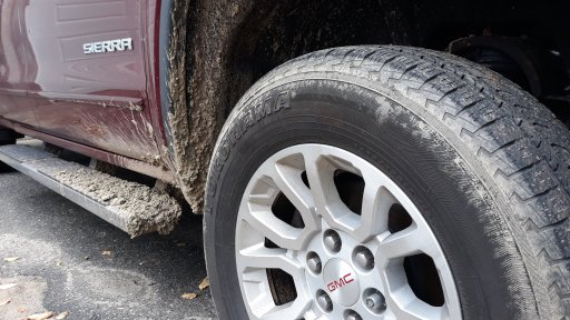

back in the '90's i was running BF A/T's, the orig ones, not the KO2's, on my '90 gm stepper. they were very good in the snow, but lacking in mud and some other terrain so i switched to BF M/T's, again the orig M/T's.
i would say they were about 80-90% as good in the snow as the A/T's, but i figured it was a good trade off, as we only get snow for a month or two all yr anyways.
after 17 yrs (yes, 17 yrs) with the M/T's, they finally wore out and i replaced them with BF KM2's. after 2 yrs with these, in my experience, i find them to be just as good as the A/T's in the snow and perfect for any other kind of terrain.
Nice GMT400 truck. My favorites
