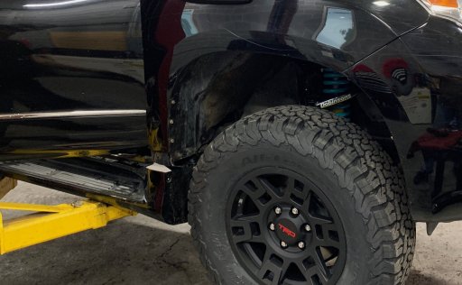

I put a Dobinson 2.5" system on my 2012 GX and have been very happy with it. It supports 33" tires and has been tested on over 20K miles both highway and rough off road. 33" tires are really the max for a GX without getting into series rubbing issues.
