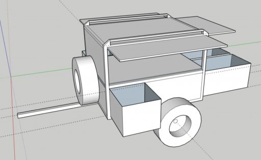

So i got playing around with some 3d modeling last night and I am thinking that I may keep the solid axle but still try a coil suspension for fun. I can build a trailing arm style setup and mock it up with my 2000lb axle that I already have and swap out to a heavier axle down the road once I get everything set up the way I like it.
Here is a rough idea of what I have rolling around in my head.
I've never used and CAD or design programs before so the drawings are a little rough.

I kicked around a trailing arm when I built mine. If I did another I would most likely go with it. For the springs I would either go with a poly airbag inside the coil or just a standard airbag. If you buy one of the modern standard airbags, they have an internal bump stop. I added airbags to my leaf's.
You will also want to either triangulate the arms or run a panhard rod. If your good at fabricating a Watts link would really rock instead of a panhard.
If there's any scale to your drawing, I would center the axle under the body. Your modern axles come with positive toe and camper. This keeps it tracking straight on the highway and the centered axle gives you better maneuverability off road.
good points. I'll look into airbags and see if I can find something that will work but the springs are a fairly small diameter so an airbag in the spring may not be an option. The trailer is based off of a 4x6 platform and I have the rear axle placed 2' in from the rear. which almost matches the jeeps wheelbase perfectly which was my though when designing.... I've never built a trailer from scratch before, though I've built many other things as I am a welder by trade. any advise is welcome! lol

Mine? The axle is centered on the 4x6 platform. My Son-in-law’s, he had one custom built, the axle is set back, even with his water tanks in the rear his tongue weight is way too heavy 250 lbs +/- and impossible to change it other than having the axled removed and centered. Good luck
View attachment 246332View attachment 246333View attachment 246334View attachment 246335
Go to an offroad shop that lifts Jeeps, they will have a pile of control arms and will probably give them to you. Build/buy mounts and you're most of the way there
