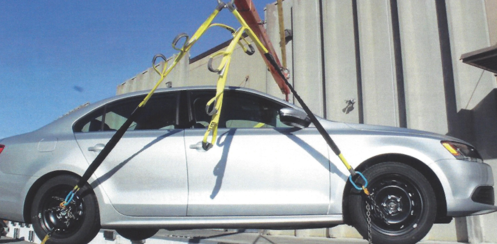

Something like this with more loops is what i'm looking for ;)
The strap in the picture is part of a kit sold at
aw direct. You can buy them individually for $125.00 as a replacement strap part number SBS03. The working load limit is only 3,300lb since it's designed to be used as a set of 4. Maybe use several 3' or 4' slings looped together in a basket configurations so that you end up with multiple baskets that you can easily pull off individually as you get to each one?

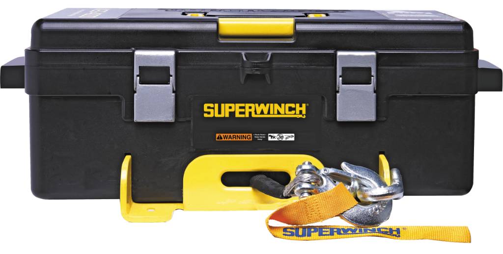

Always use a RECOVERY strap. Not a chain or a towing strap.
I have seen the carnage of both.
If you are using a highlift get a static recovery strap.
I am in the same situation, having a Jeep Patriot. Though it is modified I like to play it safe and winch backwards and find a new safer or more predictable path.
I use "winch in a box". It needs the snatch block most times and I had to buy jumper cables and attach a quick connect to one end to reach the back but, it is GREAT!!!
Sent from my SM-G930W8 using OB Talk mobile app

The only challenge with this setup, is the short pull, before releasing tension, and setting back up. The chain allows for a longer pull, and to maintain tension, when you get a new bite to continue the pull. If we had a strap (or a rope) that provided the benefits of a chain, it would be the best of both worlds.

Chain for static pulls (hi-lift) is perfectly fine/safe (not weight) and works well with there offroad kit. What I did was add a 66foot arb winch extension (static=no stretch when your working so hard to move something) to my setup to give me more distance ( I still carry 25feet of chain though. I have a electric winch but like this setup for side or backwards pulls. I mostly travel alone and need to be able to recover from almost anything if the need arises. If you don't have one yet get the hi-lift attachment that lifts from the wheel most of the times this would work. To get unstuck lift wheel and stack a rock to get more clearance or lift and fill in the hole.
