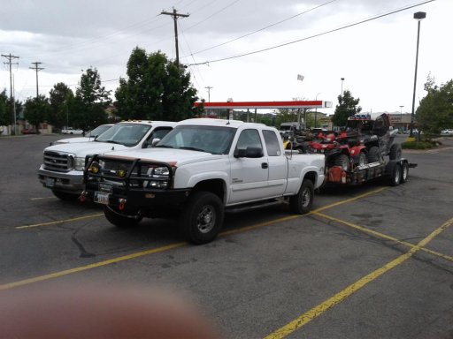

I looked at both 30 and 50 caliber cans. I liked the 50 a bit better, because I was looking at hard mounting the compr in it, then slave for the hose and cord. I stopped because I’ve been starting to take a harder look at the amount of stuff, and weight, I’m carrying. Five pounds here and there adds up.
I purchased the Vivair extension hose because I have a 22 foot duckbill flatbed along with my extended cab Silverado, so reaching from under the hood to the battery, and to the back 40 (tandam axle) was stretching things a bit:blush:
