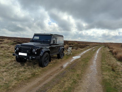

Did a not of laning yesterday , good fun. Keen to do more! Thinking I might need to lift her a bit to ensure she can twist properly over more challenging terrain.

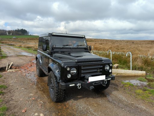

Thanks for the comments Lee. My concern is that my wheels are now too large and don't tuck inside the arches as originally intended. The weight is also an issue now as I have kitted it out in the back and have a heavy roof setup too.
The old man emu stuff does look great but wouldn't fix the flex issues, or limitations from inside the arches, what would you recommend to alleviate this issue? The road manners part has been my main reason for not doing so far.
What size tyres? do you have wheel spacers?

Gwyn Lewis do some nice spacers that might help you find your sweet spot. spring-spacers
Personally im not a fan of wheel spacers even though the riders stance does look cool as F$&K it puts extra stresses on wheel bearing and swivel balls. For me i do not want them type off issues when out on a jolly
unfortunately I can't get away with smaller as I believe the offset isn't correct. I.e. it rubs. I'd lose a lot of steering too. Simply a bit on the big side sadly.
