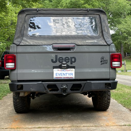

My rig is a 2021 Jeep Gladiator Willys with stock 255/75R17 MT tires. I have a soft top and a Softopper over the bed - no racks. I just replaced the factory plastic bumper with a steel, slim, high clearance bumper. The 2” receiver is now located where the license plate used to be, and the license plate is on the tailgate.
The new bumper eats up about 4” of spare tire real estate under the bed. When overlanding, I have toolboxes, a fridge, and a kitchen/sleeping platform that takes up most of my bed space.
The problem is where to mount the spare? I picked up a hitch carrier that folds down to access the tailgate, but does not go far enough down now that the receiver is so high. I would also need to relocate the license plate and light to be legal.
I like the idea of a swing out - either hitch mounted or bumper mounted - but they are unrealistically expensive.

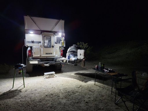

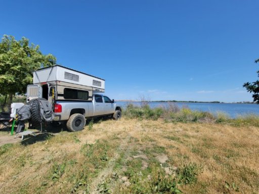

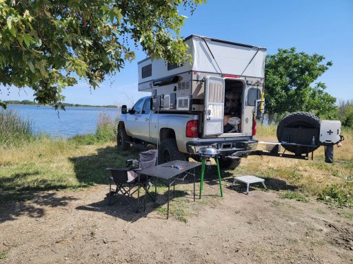

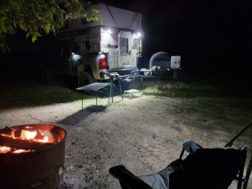

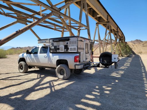

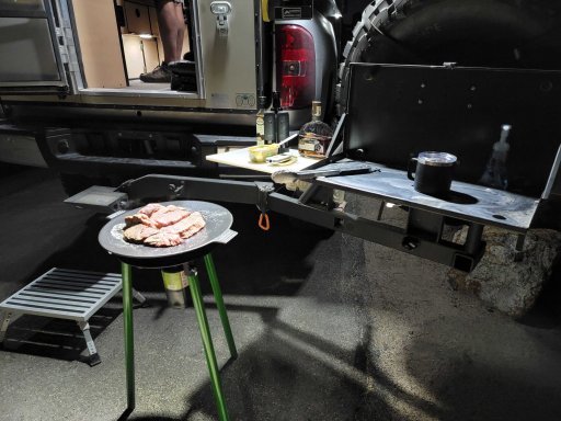

Yes, it's crazy expensive, but I love my RIG'd, and really it was still less than an aftermarket bumper + tire swing out. It's super solid, and swings nicely even with my heavy-AF 37x13.5-17". It's one more step anytime I want to get in/out of the camper while on the road (I obviously just leave it open at camp) but IMHO that's worth it to have a spare. I got the table and "side hack" cuz I'm a bit (lot) of a gadget nerd... but honestly I find the table SUPER useful. I'm always using it for something, and is great for doing a quick lunch on the trail when I don't want to set up my camp table and/or pop-up the Fourwheel Camper to have counter space. Heck, I even use it most of the time when I stop to air up just to set my stuff and "hang" the inflator portion of my Morrflate setup (did I mention I like gear?). The "side hack" provides a decent spot for my chainsaw bag. I had to get a bit creative running the mounting strap up "over" the top of the side hack, around the rotopax mount, then back to the bag so that tightening the strap pulls the saw "up" but it worked out great. Oh, and then there's also the rotopax mounted on it, which I use as a hand-wash station (great for those times when you don't want to pop up the whole FWC or use the outdoor shower hookup to just wash your hands).
