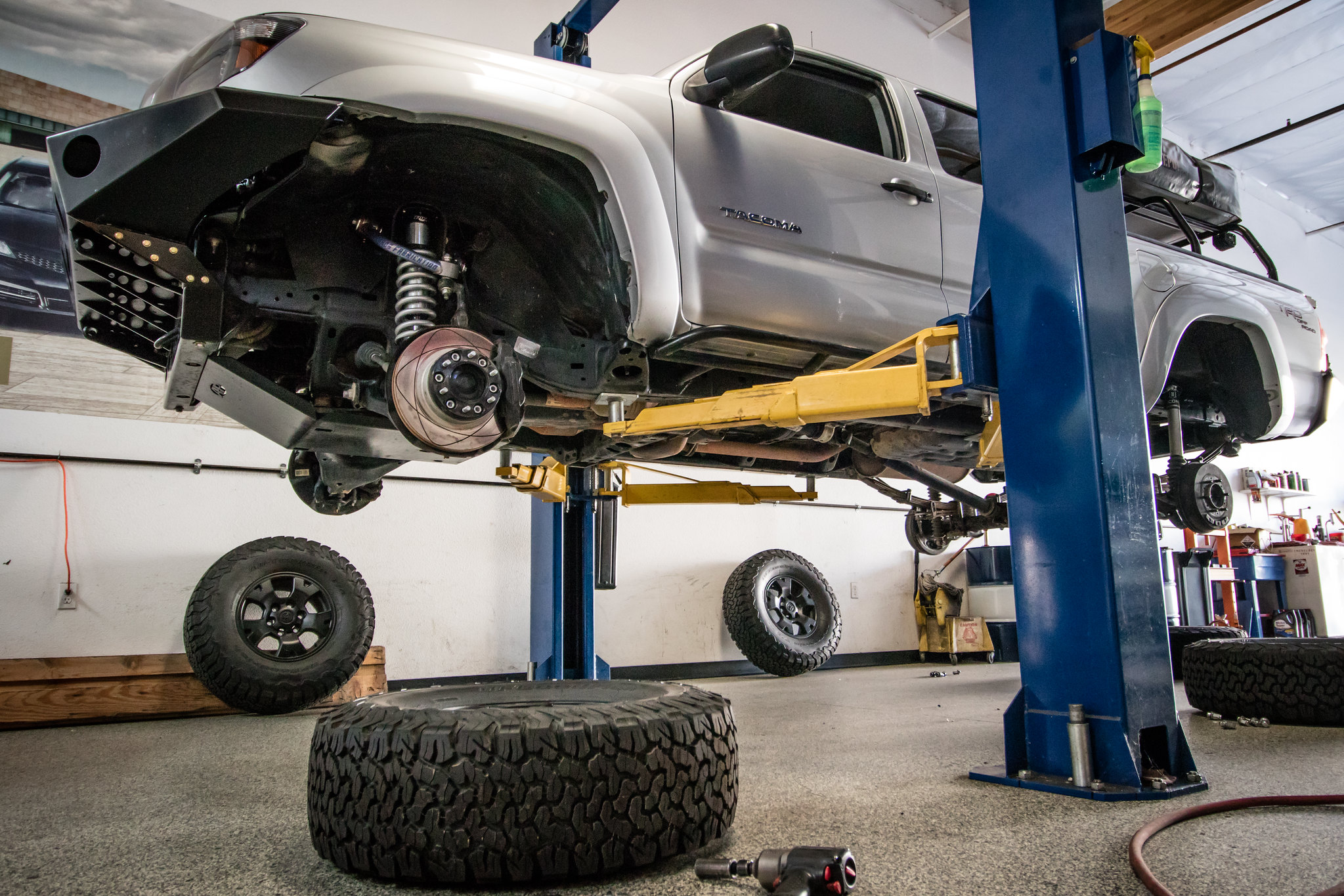

Good preventive maintenance goes a LONG way when it comes to having to carry spare parts. Inspect, catch and replace worn/common components before hitting the trail. It's mind boggling how many people just drive their vehicles into the back-country without giving it a complete once over, spending time wrenching instead of wheeling because something simple and stupid.
Of course there is always going to be break downs that cannot be foreseen and stuff does happen, but I'd say 80-90% of issues can be prevented. I don't carry much in the form of spare parts. Basic fluids, spare belt, full electrical bag with testing equipment, tire patch kit, various nuts/bolts and the usual quick fixers like zip ties and duct tape.
Proper Preparation Prevents Piss Poor Performance.
Inspection:
  • Engine: Check/replace oil & filter. Check for leaks. Check air filter. Check belt and for noise coming from pulleys. Verify that scheduled maintenance items are up to date. Inspect motor/transmission mounts.
  • Cooling System: Never start a trip if vehicle has tendency to overheat. Check coolant level. Check for leaks. Check radiator cap. Insure hoses secure and not soft/spongy.
  • Drive Train: Check for leaks. Verify that scheduled maintenance items are up to date. Check for play in u-joints. Check front and rear bearings for play, roughness and noise. Check front drive axle joints and boots. Grease all zerk fittings.
  • Suspension & Steering: Check for play/stiffness in ball-joints, tie-rods, uniballs. Check leaf pack, shackle and mounting hardware. Check front coilovers/rear shocks for leakage and mounting points are secure. Grease all zerk fittings.
  • Wheels, Tires & Brakes: Check and set tire pressure. Check for punctures, tears & gashes. Torque lug-nuts. Inspect pad/shoe linings. Inspect brake fluid level. Inspect brake lines for cracking and that they have enough slack and clearance for turning and suspension travel.
  • Everything Else: Address any issues and/or concerns you had last trip. That thing on the back of your mind? Check it and fix it! Every vehicle has it's quirks and you should take care of them as needed.
The 6 P Rule by Explore Desert, on Flickr
