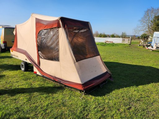

Welcome to the CombiCamp 2000 Sport - a compact trailer tent designed in the early 60's and sold pretty much as originally made right up to the present day. Made in Denmark to a high quality these still command good money and have a following worldwide.
Our example was manufactured in the early 1980's and is the smallest 'Sport' model offering a full sized 150x200 bed (large roof tent size) as well as and additional equivalent living space. The option al awning provides an additional 4mx3m area. In totoal that's an area of 5mx3m or 15m2.
For it's age it is in remarkable condition. Although there were issues to attend to:-
- It has a single hole in the canvas due to wear and tear.
- The canvas needed reproofing.
- Someone had fitted a trailer board to bodge the electrics.
- Minor fittings were missing.
Here is the trailer as collected. Cost at this point £400.
It tows beautifully but due to the low height bounces a little sometimes. More on that later....

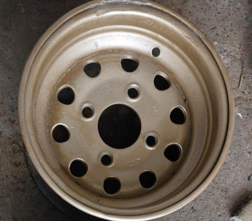

A riser/spacer between the plates and chassis should be easy with some box section and longer bolts. Add a pair of 10" Mini wheels (same 101.6 stud pattern) and matching farm trailer tyres and we should see an easy lift.
I plan to use Weller Sport steel wheels to match the modulars fitted to the Amarok.

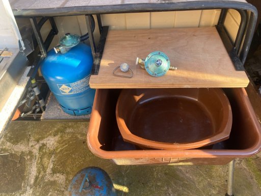

More on the CombiCamp kitchen unit.
Having found an online history I have placed my CombiCamp around 1985. Prior to this refreshed model CombiCamp offered a kitchen unit which clamps onto the drawbar chassis. It can be seen on the brochure cover below top right and bottom left.
A simple design with a diagonally split reinforced plastic military style tub/crate the unit has slide out wash bowl, cooker shelf, chopping board and space for utensils, washing paraphernalia and a gas bottle. The unit can be removed from the drawbar and mounted on tubular legs.
By pure chance I have managed to find one on it's own, seemingly complete and here in the UK. Needs a little TLC but appears complete and partially refurbished.
I haven't chosen which cooker to use yet (Coleman Unleaded double), Origo 3000 Alcohol double or gas canister single). Input welcomed on what is the best Overland cooking setup.
