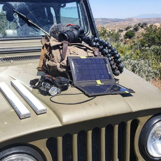

I have used Goal Zero products for a few years and have great results. Mine are not hard wired to the vehicle, however it could be easily done and they also offer various cords and adapters for vehicle applications. Additionally, their customer service has been both prompt and pleasant. I currently have 4, 7 watt panels and 1, 20 watt panel, which can all be daisy chained together if needed.

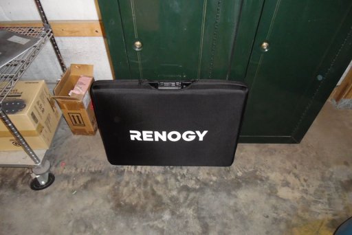

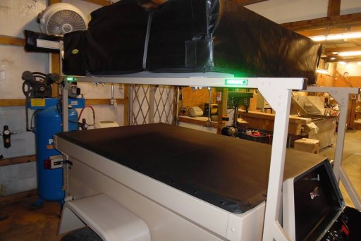

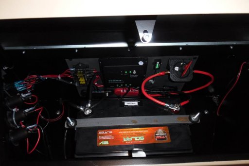

26230105_1550818344967034_2206969251830439907_n.jpg 26230474_1549834478398754_3257307193430983986_n.jpg 26167847_1550820881633447_1041361308531271281_n.jpg 26230105_1550818344967034_2206969251830439907_n.jpg 26230474_1549834478398754_3257307193430983986_n.jpg 26167847_1550820881633447_1041361308531271281_n.jpg as for me, what I use & done a year of research I went Renogy. I like their customer service, which had a positive impact on their product. I explained what I was doing for my trailer build & what equipment will be used @ certain times of the year & how long (hours during the day) along with giving them all the technical information as of draw. They came up with a fail safe system that will suit me for all 4 seasons. Battery I went with VMax Tank 125 amp hour AGM with 10 to 12 yr life span, worth every dollar spent. I have (2) Renogy 100 watt portable suite case style Monocrystalline solar panels this way I can use 1 or 2 panels (only one shown in the photo) ran together when ever I need the extra power. Renogy 30amp Wanderer Charge Controller w\ battery temperature sensor. I have 20ft of 10 awg cable to stretch out. I have 30amp fuse in between the panels & the charge controller to protect my system. I run Engel 22qt 12v. fridg\freez 24hrs on demand, Propex H2000 Heat Source tent heater on demand "seasonal", Mighty Kool K2 12v. A\C "seasonal" only at sleeping hrs, 2 LED filtered green lights on the tent rack & the LED tent light strip. I believe you get what you spend. I do not trust China made solar panels or their components.
