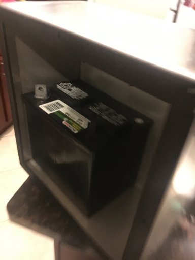

DDC040D3-46FB-401B-9D43-3AB3DC5CC6BC.jpeg 669148A0-FAD4-47F0-A1F1-43D9CF03581C.jpeg
I got a stainless steal electrical weather proof donation from legion lighting. Got a 12 volt lawn mower battery. A 120 watt solar panel from o solar. Looking at an duwalt inverter, and the project is on its way..
