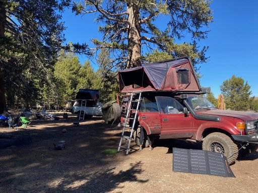

I’m running a 100watt rugged flexible panel on my tent and then have a foldout 95watt panel of the same voltage and manufacturer used for base camping typically. The permanent tent mounted panel is great to keep a constant float charge when not on a trip and has kept my fridge running indefinitely, as I am typically parked outside my house and work with open sky. The fold out comes into play when camping and the tent is open and/or under trees, or where I need more charging t.393E76FE-4E39-41BF-87DB-A484640CA8AF.jpegB6877FA2-1C6C-4D9F-8F34-FF96B5CF5867.jpeg

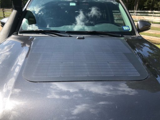

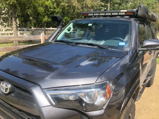

I have 2 panels on my 2018 TRD 4runner. A 100W Renogy fixed panel on my roof rack and a 90W hood mounted panel from Casacadia 4X4.
I have to say the hood mounted panel is very clean and super easy to install, you just have to have a flat non-scooped hood. I found there are plenty of SR5 4runner owners with the flat hood willing to swap for a scooped hood, so that's what I did.
The roof mounted 100W panel has to come off when my rooftop tent goes on. In that situation I have a smaller 50W Renogy panel that I mounted to the top of a Alu-Box that goes on roof rack when RTT is on, uses same wires/plugs for either panel.

Very cool, I like that. How does the panel adhere to the hood? The dark panels matches your rigs perfectly.

The edge of underside of panel is pre-mounted with the same 3M tape they adhere glass windows to skyscrapers with. Cascade 4X4 sells the whole kit, was pretty easy. The panels are shaped for your car's hood shape. Not sure if they have a Chevy hood yet but frankly some sizes/shapes are generic enough that if you don't have hard ridglines in your hood you can find one they have that will work.
