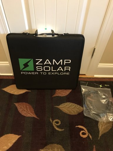

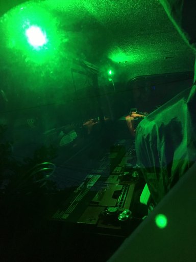

Currently using 150 watt, but I have more wattage consumption than you.. it’s better to have more than less. I am currently charging three odyssey agm and another emergency backup just Incase. D5064E6C-916A-4C24-A816-4992F82339C9.jpeg3B0D3701-222E-4BC5-AD6B-15FBF2767756.jpeg03EF4CA4-0454-4AF9-9F2D-EAC62E99E88C.jpeg

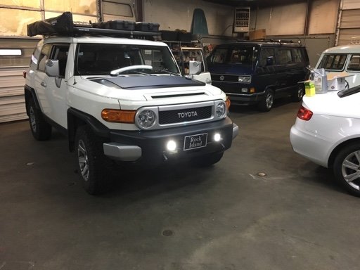

I had an 80w semi-flexible panel permanently mounted on my FJ’s hood. It worked great, providing enough power to run my 50qt fridge full time. It was managed by a VictronConnect charge controller.
Any more details on which panel you used? I have heard these flex type panels do not last very long, sometimes less than a year, did you experience any durability issues with your panel?
My panel was rock solid for just shy of three years. I removed it when I went to sell the vehicle. I’m going with a pair from the same company next month for my current build. I did learn that with these panels less is more when it comes to mounting. I used a LOT of 3M bonding tape, and am pretty sure I damaged the 80w when I removed it. I’ll test it when I get my new setup in place since I might use it as a portable panel in the future.
The panels are by lensun, so they are not generally considered off brand or cheap. I was concerned with reliability since I wanted to run my fridge 24/7 and was right at the min number of watts to do it. The new setup will be running 110 watts of the same panels.(bigger hood!)
