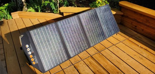

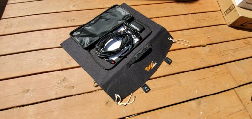

I've been using an unregulated portable folding panel from Togo Power the TSP-120F. It's a 4 panel 120 watt output.
It's waterproof, well made and comes with good cable. It has zippered pocket for the cable, adapters and the manual. It is free standing using the folding legs or It can be hung by its grommets. We often lay it over the windshield.

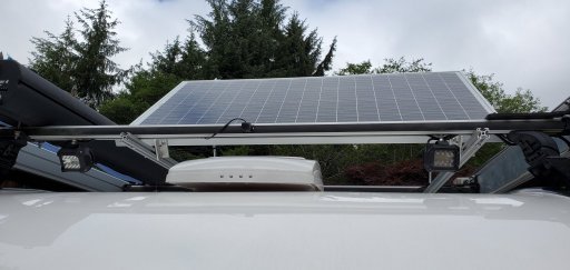

We use a standard fixed framed 150 watt panel from Rich solar for our roof top. I have it attached but with adjustable pitch and it's removable for when we are camped in the shade.
The folding Togo rig is compact and super portable but the roof top Rich is nice because it is always on duty.
Reactions: DMS1 and jclavell

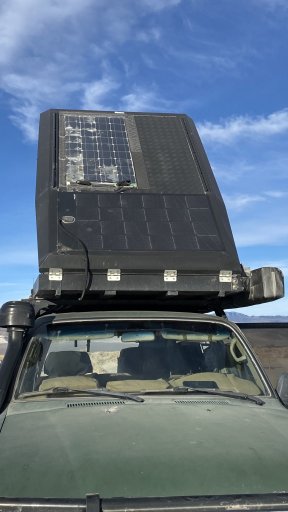

Don’t buy cheap flexible solar panels. The small amount of savings doesn’t pay off in the long run.
Pictured below is a good example as to why. Renogy flexible panel (above) failed in 2 years, then upgraded to a quality flexible panel made by Merlin Solar (below). Merlin is sold around the world for military, marine and commercial fleet use, all flexible panels. The roof or hood of a 4wd overland rig can be some of the harshest conditions for a solar panel to live. Vibration, dirt, heat, and objects hitting or sliding over these panels require a rugged built panel. I wouldn’t bother with a delicate glass panel which is why rugged built flexible panels are the way to go. Check out Merlin here:
