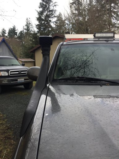

So the 100series safari snorkel fits the sequoia.
Big Tree
Thought I would try , here it is.

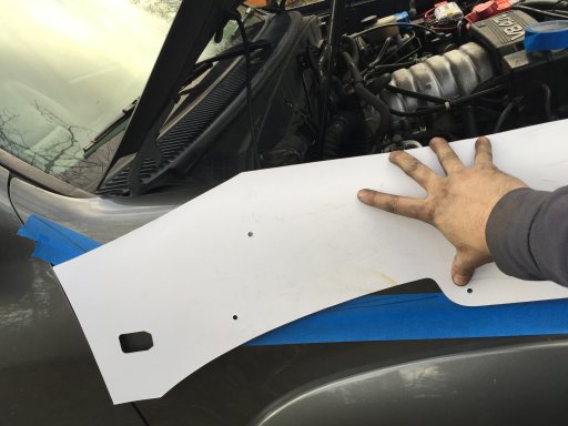

Using the hole pattern template is good but needs to be brought forward about an inch to just cover antenna hole and get closer to the air box hole in fender. The upper bracket doesn't work but I make a template of one that will and just need to laser cut one from stainless steel..I'll update when installed
Big Tree
No air box remains, the 3.25" tube leaving the air box enters the fender well..the snorkel is to attach to this however the rubber snorkel boot (shown in one of the pics) is 3.75" id so I needed to make a tube to fit this otherwise good fit..
