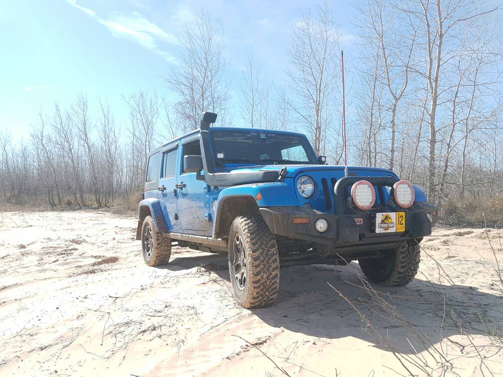

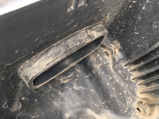

I have a snorkle on my 2015 Jeep Wrangler.

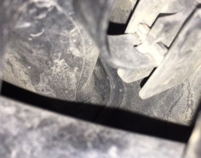

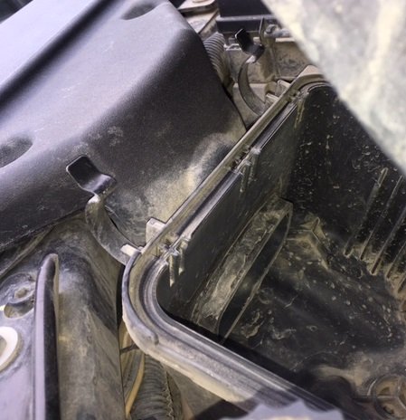

My question is, what gasket is used to seal the space between the top and bottom halves of the air box?
I have the air box sealed all but the space between the top and bottom halves.
Thanks!

hey indy blue...i used a urethane caulking to seal the two...just sand the areas for a rough surface so the two can get a better bond.

I've just used some RTV. Comes off easy when you need it and goes on easy when you are done.
