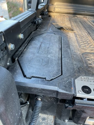

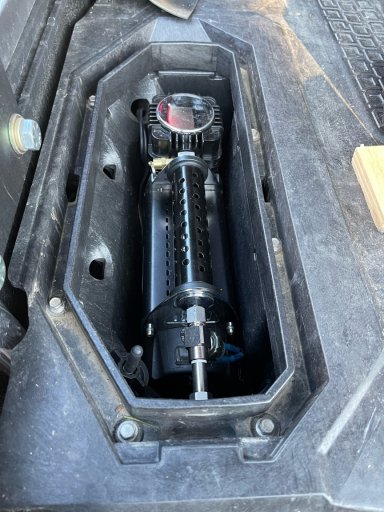

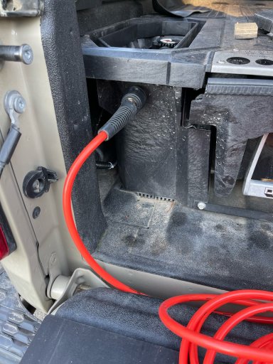

Today’s project was to mount my Smitybilt compressor and hardwire it into my switch bank.
I took advantage of one of my Decked “ammo cans”, which fit in the compressor nicely. Only thing I had to do was remove the base. Since the base has rubber grommets and feet to absorb shock, I added an inch of dense rubber to the bottom of the can to reduce vibration. (I also changed the fittings to NPT and extended the output so it comes output is accessible outside of the can)
Electrically I added a 60 amp relay and 45 amp circuit breaker to the hot side feeding the compressor. The switch bank enables the relay.
The compressor runs hot so I added a pressure switch so that it doesn’t run constantly and I can pop the top off of the ammo can to provide cooling. Works like a champ!
