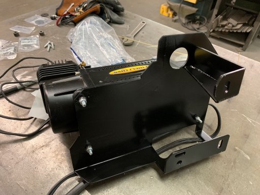

Hello everyone,
So I was looking around for some ideas to mount my smittybilt compressor and realized that no one makes an on board mount for these.
So I fired up CAD and got to work. Only place this would really fit is where the ARB mounts or dual battery on the passenger side.
Took a few measurements, punched out a mount, then had to trim quite a few places for clearance. Updated the CAD model, but it fits.
I need to wire it up to the battery. Thinking I might have to go the switch pros route to fit in with some other accessories.
I also have a little manifold in the works as well. It will have two pressure switches, one so it can auto shutoff once it reaches 120 psi for general air use. The second one that is adjustable, so I can fine tune it for tire pressure.
The idea is to be able to hook up to a tire, inflate then it will shut off once I reach 35 psi. The plan is to have a throw switch to differentiate the pressure switch that will be used.
