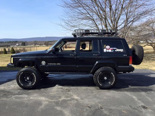

Thanks. My rock sliders and winch are Smittybilt as well. I've been very happy with fitment and performance. But I've read quite a few bad reviews when it comes to their seat cover and stuff like that. But honestly, I think for the money, their products are a good value.

I was looking at their rock sliders as well, I am going with a ARB front bumper.and that rear SRC bumper,
