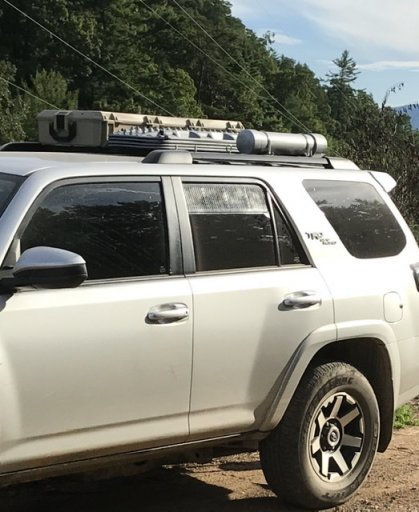

something about storage of 1lb tanks, get some 4' pvc pipe and a 1lb tank will fit nicely in there. I glued a cap at one end and a screw on at the other end.
you can kind of see the two of them behind the Yeti in the middle
Tundracamper
3,068
Tuscaloosa, Alabama, USA
Shepard
22670
That’s how I store them. But, on the roof rack it has to be horizontal.

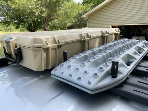

nice set-up on top of the rig
Well thanks. Here’s the most important part, where the fire pit will go in the Pelican case with a little firewood:)
Obviously, I’m debating about adding a 5 lb vertical tank or extending the pipe to take one or two more 1 lb tanks. I really don’t want to add much to the height. I sure wish I could get a set of four 1 lb Flame Kings for under $100. That would be the best approach.
