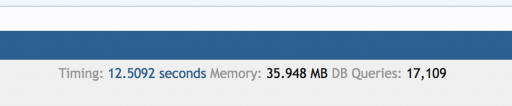

if the "DB Queries" stat in the footer is correct than it requires a surprisingly high number of queries to render a single page.
Yep, thousands is pretty typical. You brought it up in another thread https://www.overlandbound.com/forums/threads/page-load-times.14899/
Just brining up the list of threads in the support forum takes a lot of resources:
And loading this thread:
It isn't local cache, either. If I reload the page, the timing varies a couple tenths of a second, but the memory and number of queries stay the same.

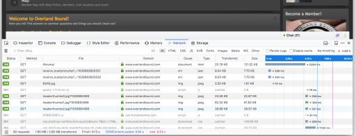

@Steve ,
You mentioned that you see a pause before the page even starts rendering, which is the same issue I am seeing. Looking at the network requests for a random forum page it is taking 4-5s just to render the html. This supports my original post(s) that the large number of queries are a major cause of the slowness since all of those queries have to finish before the response is sent to the browser.
Unfortunately moving to AWS will likely not significantly help this issue. The database will still be getting slammed by queries and acting as a potential bottleneck. Adding more web servers will not help. The best solution is to greatly reduce the number of queries. As a point of comparison, if I see more than ~100 queries required to render a single page in our applications I start looking to see if there is a problem in the code.
