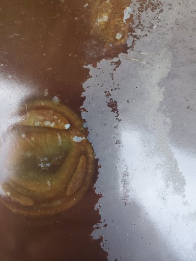

Hi Everyone,
Over the holidays I decided to pull the trigger on the Tembo Tusk Skottle. Today was my first time using and I experienced issues. The season in the center flaked off into the food. I cooked fried rice for lunch and I could see flakes in the food and it tasted funny. After doing the clean up (like video on tembo site), I noticed that a good portion of the seasoning is gone. See pics of the aftermath...
I'm not sure where I went wrong. I used a silicon spatula and I was not rough with the pan (i.e. no hard scraping). I used some avocado oil, started on low heat to warn it up before I started cooking at a higher setting. I made sure to flip/stir the food frequently since things seemed to cook fast and some rice began to stick a bit. I'm not sure if new seasoning from future use will adhere to old or if I should just take off all the old seasoning and start over. I'd love to hear some pointers for those of you who have these or may have experienced the same.

i dont have that piece of gear, but i have cooked with cast iron and carbon steel for many years. it looks like the center was overheated and the seasoning just delaminated and went into the food.
the metal doesnt look right in the pic you have, but its hard to tell from a pic. i would get an 80 grit flap wheel and a grinder and remove all the seasoning and go over the entire surface area really well and then season it again with peanut oil or something good with high heat.
do that and see how it works. its hard to say what is wrong because you really dont know what was done to it. might have been an inexperienced worker trying to season it and messing up somehow. just take it all back to bare metal and re-season it right and then if it messes up, you will at least have data that will help you figure out the problem.
if it is newly seasoned and you cooked with something acid, tomatoes, etc....that might be a culprit. ive seen tomato sauce jack up a newly seasoned pot

On mine the center cooked off, I let it heat up and wiped off the heated "oil" they say it it ready to cook but the oil seemed so pasty I wanted it cleaned off so I could start my own seasoning with olive oil.
I ended up heating it slightly and take a razor blade and scraping the rim off then wipe out the interior then oil it, all good now. Put it away with a thin coat off oil on it.
Most people just bake it in a oven then wipe it out and it gets rid of it for the most part.

Myself I would email Tembo the pics and story, see what they say....Next grubworm nailed it, follow his advice.

Curious if you were in really cold weather and it was left out. Causing it to "delaminate" before cooking. They are blanched with a sticky heavy oil that I did not care for.
I chat with Marco and Jerry all the time, just message them on instagram and I bet they would get right back to you. Or PM Jerry a message on his story.
Do not take any abrasive to it though!

Interesting I had the same issue.
I got mine last December. The burner that ships with the skottle gets way to hot very fast so you have to use it at a very low setting. The first time I used it the same thing happened to me. All the seasoning in the center came right off. Would have been nice if there was something that says not to turn it up even half way.
Anyway, I tried to season it on the grill (I contacted them and they just pointed to their websites instructions), came right off again. Tried to use the oven method, Same thing.
The skottle is carbon steel. When I bought it everything I found said it was cast iron so I was treating it as such. Seasoning shouldn’t be much different, but I own several cast iron pans all non-stick. I have never been able to get the skottle seasoned. It’s not non-stick at all.
So now, I don’t even use it. Every now and then I’ll try, use plenty of oil, but as soon as you put something on it it sticks and burns. I’ve gone back to just using pans and a burner when I go camping. There easier to clean up, and takes up less space. May end up putting the skottle up for sale soon since it’s collecting dust now.

It's just as you put it. I took off all the old seasoning and did 3 bakes where it looks great, then I do a cook and it all comes off even at low heat. I've repeated this now 2-3 times and it never takes. I still use it to cook and think it is what it is. I can't use it as a stand alone item. I take a separate single burner and non-stick pan for things like scramble eggs. I just use it for meat and veggie stir fry. It's a shame because for that price I had high hopes. I was better off with just my double burner Coleman.... tried and true!
I cant count the number of times I seasoned it in an oven with it looking great after just to come right off! High heat, high smoke point oil, all the correct steps. Like you said, it is what it is. I have used it on 2 camping trips since I got it, only because I was in a group and had to cook a lot of food like stir fry. When its just me or I only have to cook for one or two people, my jet boil setup has never failed, and the pans are completely non-stick. I had high hopes too, but its not as great as people make it out to be.
So, after seeing this I decided to give another try at seasoning it, not following the methods on the Tembo site, but how I would my carbon/steel pans.
So obviously it’s not cast iron, and it comes with a layer of corn oil seasoned on it once (like it looks when we take it out of the oven). What I did was first removed anything that looked like it was burnt on with a steel ball and water. I then peeled a five dollar bag of potatoes, and fried them in a ton of salt and canola oil. I turned it up to a medium high (not fully opened) and added oil along the way until all the skins were crispy. I then cleaned it with just water and paper towels, added some oil and fried an egg. It stuck in one time sized spot in the middle. Which once I broke it loose it was non-stick. You can also gauge how hot it is by how fast the egg gets crispy around the edges and get a feel for how open the burner needs to be.
It sounds like you ordered yours around the same time I got mine, so the burner comes with an adapter the burns really hot. Almost to hot. We both seem to have the same issue with the seasoning to. Could have been a bad batch.
Anyway hope that helps you. If you can’t fry an egg and freely move it around do the potato and salt thing again like you would carbon steel. The instructions provided even says “like a cast iron” haha.

Not sure what the BTU output of the burner is, but it may be too high. I’ve had stainless steel turkey fryers that burn at 60k BTUs but most of the Camp Chef burners stick to the 30k BTU range. The higher output burners were designed to be used with large steel kettles and flame tamer shields, not aluminum stock pots or with direct to metal contact. 30k BTU burners work better for non steel contact or without flame tamers.
60kBTU will burn the seasoning off cast Iron. Carbon steel is even more finicky. It is so because it’s not porous like cast iron. If you blast carbon steel in one spot, it super heats and cools quicker, the further away from the heat it gets, vs a more even heat and slower to disperse heat that cast iron provides.
you had stated the Skottle was carbon steel. If so then a lower setting or burner only capable of 30k BTUs might help keep your seasoning from flaking off. Or you may place a diffuser plate between the burner and the disk. If you choose to make a flame tamer (brand name) diffuser yourself, either use 1/4 inch to 3/8 inch stainless about 8-10 inches in diameter and drill concentric circles of 1/4 inch holes in it, or if you choose softer steel use 3/8- 5/6 steel (so it lasts longer) and do the same.
using a diffuser will keep your skottle from super heating in the center and burning off your seasoning.
as for re-seasoning your disk, or any pre seasoned Steel or cast iron cooking surface, I’d recommend an electrolysis tank over a flapper or grinder, especially on cast iron, as it will clean the pores missed by an abrasive process. Then the oil used to reseason it will sink in and coat better and be less likely to flake off.
properly re-applying a light coat ofoil after wash use, and wiping it off thoroughly will also extend the life of your seasoning, without build up and potentially going rancid. That’s when the surface becomes sticky and smells bad. I have had great success with olive oil for my cast iron, steel pans and steel griddles.
electrolysis is very easy to DIY. There are numerous how tos on YouTube. You can also accomplish the same effect by just soaking the seasoned or painted metal in a plastic tub filled with white vinegar, but it will need to soak longer this way. Be careful to rinse and dry bare metal quickly after thes processes, as the steel may flash rust within hours of coming out of the solution. I normally rinse with clear water and a green scrubby then place the pot or griddle in an oven at 200 degreesfor 30 minutes to completely dry it out before starting the reseason process.
I know this post was long, but if you do these steps correctly, your gear will be serving generations of your family on their camping trips long after you have moved on to a higher plane of existence...

It’s only 10,000, but because it thin steel and literally less then an inch away from the steel, it gets to hot on anything but low.
