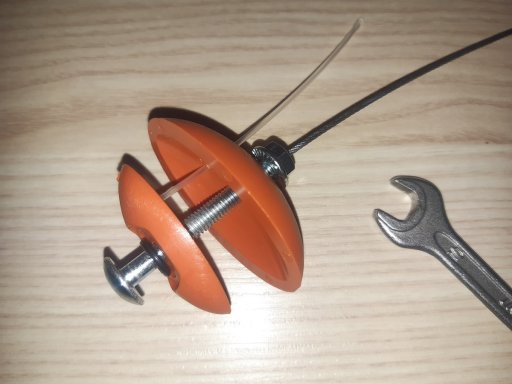

So a patch from the outside is of course very handy. What I carry in my tire repair kit is a sidewall slug from the ATV area. The sidewall slug is also a way to make an emergency repair off paved roads in case of a cut in the sidewall. As I said, it is actually designed for ATVs.

How do you use that thing?
The bolt and the rear half is inserted into the inside of the tire through the cut on the tire sidewall. Then, using the small rope and the threading aid, the bolt is pulled through to the outside and threaded into the other half. Then both bolted, inflate the tire, break off the bolt and cut the rope. Ready is the emergency repair. Her is a YT video about it:
