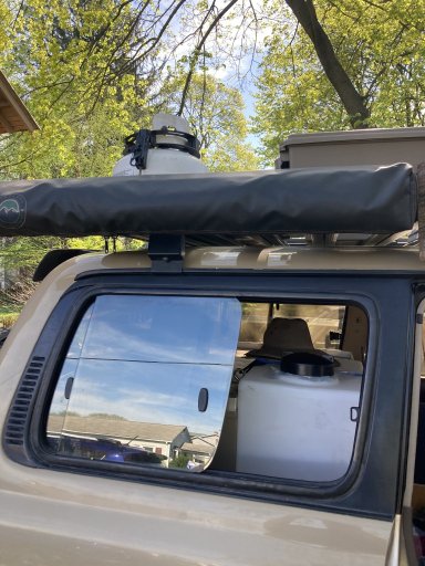

About 5 years ago we took the plunge and bought an inline camp life ( brand?) water heater. My mounted pump sucks water from a dedicated shower tank, pumps it to the heater, then hot water for the shower, using propane from a regular 2.5 gallon propane tank. The heater would be fine, cept for a couple of major problems. It simply does not hold up to the rigors of off highway travel and is literally shaken apart. Because we carry it flat up on the roof rack in a pelican case, encased in foam, there is simply not enough time to drain every bit of water from it. Even hanging overnite the water will not completely drain from it- so, guess what? Can I mention how many times I’ve had to solder it because of freezing & bursting? It didn’t even drain out completely after hanging in my heated carriage house all winter. I’m looking at the Mr Heater units. I’d like to mount it, in a box up on the racks, hook up to the propane, drop a line into our tank of water, drop shower head and shower. When done, open a cock valve, and drain water from the heater- completely. Here is our set up. Water tank in rig and propane tank up top. Is there a company besides Mr Heater that makes such a devise? The Mr Heater looks good, but is it adaptable to our desired system? All thoughts are welcome, & thanks 7C5CDD04-C806-4C1D-AF8C-468A43ADD4E8.jpeg
