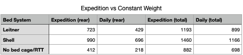

Hey guys, I'm hoping for some opinions on going with either a Shell + RTT or the Leitner bed rack + RTT. I don't think a normal bed rack is right for me, because I do want the extra storage and organization capabilities of the Leitner. Both options I'd like to put on a RTT, I have a 5ft bed Tacoma and want to do a 6ft RTT, so I do want something cab height to fit that extra foot.
The pros/cons as I see it are:
Shell is covered/secure, but minimal organization (unless drawer system), and super heavy.
Leitner is lightweight but no covered bed.
The big thing is that I am going to be extremely heavy already... I have a 2016 Tacoma, adding up all my steel armor and whatnot I'll have about 700lbs constant weight on the truck (about 220lbs of that is in the rear).
How much do I need to worry about cutting weight?? Looks like the shell is about 100-150lbs heavier but I'd probably do a drawer system if I went the shell route... which puts that setup at around ~250-300lbs heavier than the Leitner.
This weight component is really uncharted territory for me. I've never had a heavy truck, up until now I've been running ~450lbs armor and lightweight camp gear but the wife is wanting to be more comfortable for bigger trips.
This is also my daily driver, I'll drop the RTT weight but rack/shell+drawers would stay.
Looking for some real-world opinions here... weight... covered bed... organization... expedition vs daily use... etc.
Thanks a ton guys!

Normally I say topper, but since you are wanting a RTT, I'd go Leitner. Weight is the enemy. What kind of armor are you running and why? Are you rock crawling?
I do more 2-3 day overlandy type stuff, but in Northern CA the trails can get rocky quick, so I do end up scraping my bottom pretty often.
I had a hybrid bumper but have an aluminum CBI T3 bumper on order, so my armor will be:
CBI front (70lbs)
Winch (~70lbs)
Full steel skids (130lbs)... they're beasts, but I scrape/slide em on granite a lot
Sliders (~150lbs)
Roof Rack (~50lbs)
CBI high clearance rear w/ swing out (200lbs)
All pretty standard stuff... weight adds up quick though

Yeah, I've seen some guys rock the soft topper like that. I like the storage of the Leitner though so it kinda takes that away, plus then I'm adding more weight to get it covered without the security, might as well just get a shell at that point haha.
I love a lot of aspects of the shell too, just don't know if I'll regret all that weight (extra 100lbs alone, extra 300lbs with drawers)

To me a RTT with bed rack will be more stable as far as weight. I believe my camper shell holds up to 250lbs dynamic weight. I’m sure a bed rack is a lot more.

If I do shell + drawers I'll probably be about 400-500lbs (~10%) over GVWR fully loaded though. I have BP-51's and can do heavy leafs/ regear, I've never had such a heavy truck though. What do you all think about that much added weight? Will it really hinder me off-road or cause too much wear on the truck?
