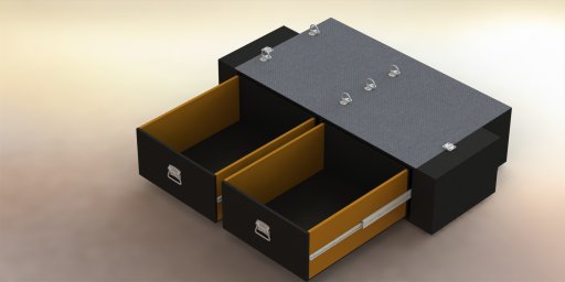

I started work on CAD-ing up a small drawer system for the back of my rover for the trip. I am contemplating having a slide for a table on top of all the drawers on the passenger side... Thoughts? Most people put the table at the same height of the drawers, however I am reasonably tall (6'6") and prefer to work without hunching over.
I have also decided to install a secondary battery system in the rear of the rover with some SLA batteries, and I am contemplating getting two slimmer batteries in parallel in the small side compartments of the drawer system.
So many possibilities!
Looks good. I was originally going to put an extra Yellowtop in the back of my RRC, but I've decided to go LiFePo4 for the second. This allows for a smaller, lighter battery, about only a fourth the weight of an equivalent SLA. I'm planning on placing my aux battery directly behind the rear seats, but ahead of the cargo drawers.

I think I have finalized the drawers after tweaking some dimensions and parts, now just to build them and install!
I have looked more into a dual battery setup and have decided to go ahead and install a small one. I will put a 17ah SLA battery (I can always easily install a second to make 34ah) in the driver side compartment of the drawer system, I believe I can fit most of the electronics I need in there, and I will keep all of the power (both 120v from an inverter and 12v sockets) located on the drawer system to prevent pulling more wires then necessary. I am contemplating installing some interior lights (12v strips?) due to the lacking stock lighting from the Rover...

If you are using less than a 20 AH, you should really consider using LiFePO4 instead of SLA. The differences in depth of discharge between the two types is huge. You'll get more usable charge and battery life from the LiFePO4, plus, I will be a smaller and lighter form factor. Initial cost may be higher, it TCO will be lower, in addition to the other advantages of LiFePO4.
I'll look into them, the two down sides to me are the price (not to Terrible, but it's still a budget build) and also I have yet to find a charger that will work on a 12V system that is designed for a LiFePO4 battery

Correct, but they'll last longer, hold charge longer, charge quicker. Penny wise, pound foolish...
