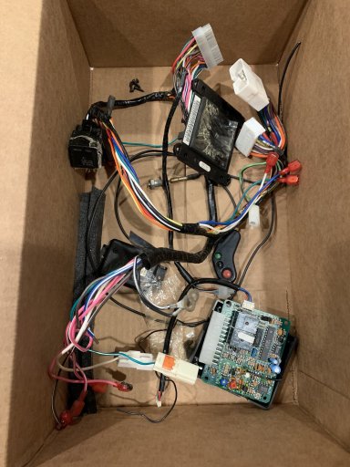

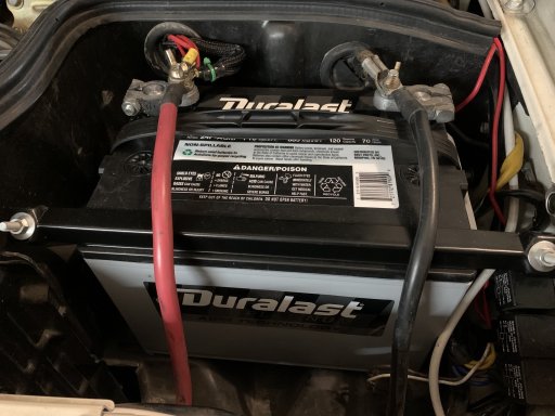

Well, my 9 year old battery finally failed over the cold weekend and I replaced it with an AGM. Here's to 9 more years! (Hopefully...)
While I was in there I decided to relocate the washer bottle using Slee's kit and install an early FJ80 battery tray for the dual battery setup I'll eventually have. The older FJ80's had the battery on the opposite side so I was able to use all OE parts. I did have to trim the box a bit where it meets the radiator, but it was a fairly simple task.
When I finally got everything back together, the port installed alarm system went nuts blaring the horn and disabling the starter and I couldn't disable it. This is the 2nd time its happened and I decided it had to go! Easier said than done as it was very well ingrained to the vehicle harnesses. After pouring over the factory electrical diagrams I finally removed the whole rats nest and it fired right up. Good riddance!
The big downside now is that I no longer have keyless entry, but I have a project in the works for that...

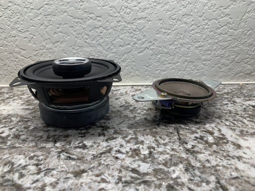

Speaking of electrical, I took the opportunity to replace the factory speakers while everything was apart. Quite the difference!
My vehicle had 2 additional amps and 8 speakers. Removed it all and installed new only two in the front doors and replaced the radio with CarPlay®. The speakers had only the magnets left after 25 years. No wonder the radio sounded so bad.

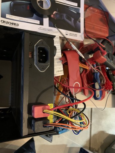

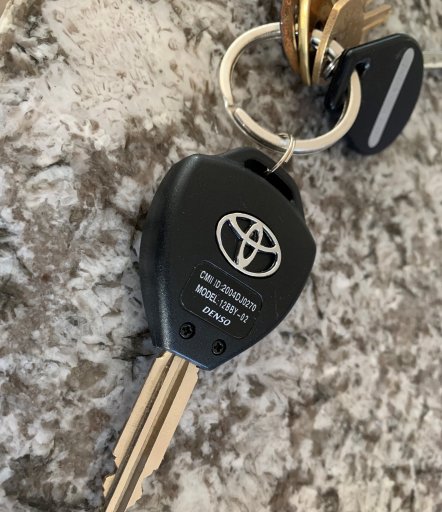

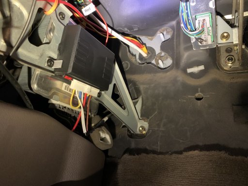

I made some progress on my new keyless entry system last night, after pouring over the factory electrical diagrams for hours. This is something I have wanted to do since I bought the truck and, now that the factory system is out, I decided to dive in.
I want an integrated remote/key solution like my wife's 2018 Tacoma, but unfortunately that just doesn't exist for the 80 series. I briefly looked into transplanting the factory system from a 100 series into my truck, but it uses signals from too many ECUs and would be impossible to program. I also definitely don't want an alarm or immobilizer system.
After quote a bit of searching, I found and bought an integrated keyless entry system on Aliexpress, but it had the wrong blank attached. Once it arrived I opened it up, cut the blank out, and used it as a template to modify an existing key. After a bit of fine tuning everything went back together and I had an integrated fob with the correct key! I also transplanted the Toyota logo and decal from a previous failed project and ended up with a factory looking setup.
Unsurprisingly, the keyless entry system didn't come with a pin-out, so I spent hours with a multi-meter and 12v inverter testing out all the different combinations. I also learned that the factory Toyota system uses a switched ground. Fun! I currently have the lock function working, but the unlock function appears to need 2 diodes to trigger 2 pulsed unlock wires which apparently is some type of security measure in Toyota's wiring. I also need to wire up a relay for the negatively switched flashers. Here is the control unit mounted with some 3D printed brackets.

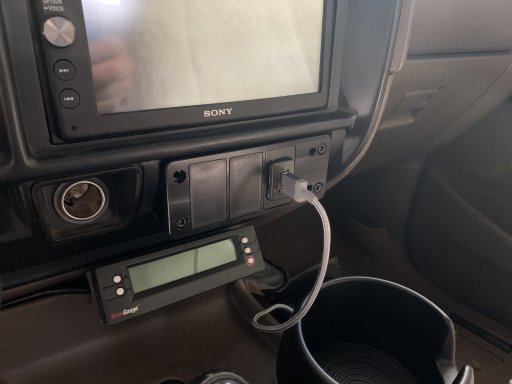

Oh, and I installed the Wits End ashtray switch panel. It currently holds the USB for the Apple CarPlay connection.

Not much to report recently. Got the keyless unlock circuit sorted, but still need to wire a relay for the flashers.

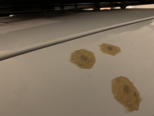

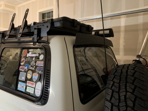

I also installed the optional rear wind deflector. The PO ripped it off somehow and plugged the holes with a sloppy fiberglass job. Finding the deflector was the hardest part. It took me over 2 months to source the parts...
