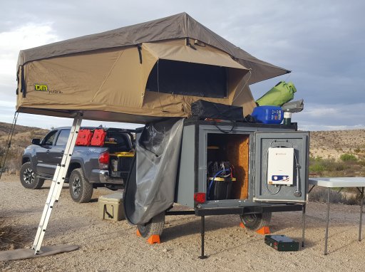

I have had 3 RTT’s TJM, CVT, and 23 Zero. All held up fine in strong winds even with the annex on when properly staked down. BUT they are very loud and will rock you trailer or vehicle. Anything that isn’t tight will flap all night. Window shades, rainfly, annex etc.

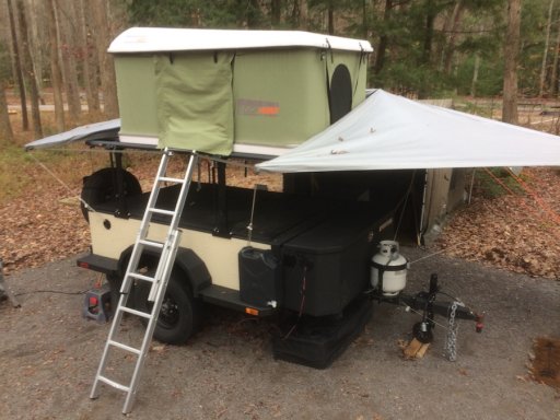

I've had great luck with both my hard shell RTT (Roofnest Eagle) on my trailer, and my ground tent (OZTent RV-5) in windstorms when others around me had their tents collapse or main ridge poles snap. I think a lot of it has to do with the gear you choose and how well you rig it.
I purchased both my RTT and ground tent used for about half what they cost new, and both were hardly used. If cost is a factor, shop around, you might be surprised at what you can get from people who wanted to try this or that, but are switching it up now.
I was going to go with a fold open RTT, and there are some great ones, but in the end chose one that pops up super quick and closes up just about as fast. It's been great in high winds.
The RV-5 ground tent, when staked out right and even with awning and rainfly, is amazing in storms and high wind. No flapping sounds, handles the wind quite nicely, and you feel snug and secure.
The best though, and the one I choose most often is sleeping in the van as all my stuff is already in there where I need it, close at hand and organized. Handles the wind and rain like a champ, of course, and over the years I've come to look forward to storms and falling asleep to the sound of rain on the roof.
Here's my full base camp type set up. I don't always have it all set up, but when I do, I drink Dos Equis :tongueclosed:
This was a five weeks in one place experiment to test gear, tweak set-up, and see how various parts of the set-up hold up to use and weather. I had a ton of interesting and challenging weather, too.

I have had mine since January 2016 so not that long but we have used it quite a bit. Like I said previously it's been beach camping with a constant strong wind and stronger gusts to desert camping with equally strong winds and I literally can not find a stitch that's broken. It has even survived my son who is now 4.
My tent is a TJM Yulara which is the same as several others (or was when I bought it) such as the ARB Simpson 3, Tepui Autana, and whatever else. They appear to be manufactured by whomever and then a logo slapped on it for whatever company.
If you are at all hesitant to buy a rtt don't be. They are very strong and reliable. I have thoroughly enjoyed mine and we have many great memories and many more to be made in the future.
