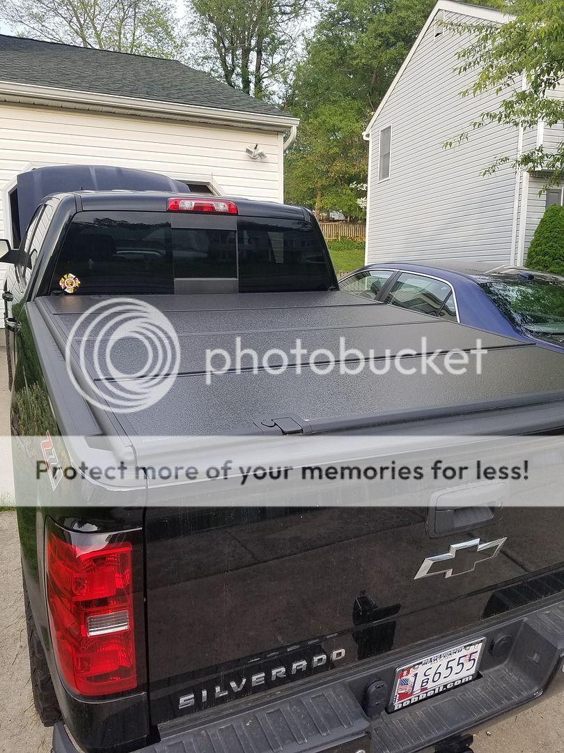

My question is, I'm hoping to set up a RTT on my silverado crew cab, but the racks from thule and rhino racks are both rated for 165lb (I'm guessing dynamic or in motion weight rating). Do you think these racks would suffice? The tent is well under the load limit, but the static load would be the tent plus me (190) and my girlfriend (100). I can't really utilize a bed rack right now due to a tonneau cover.

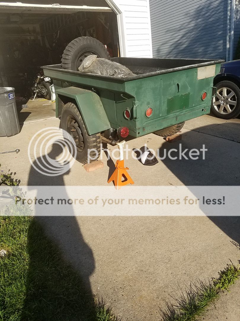

I also just bought an m416 as an alternative but have no welding skills to prep it and am debating selling.

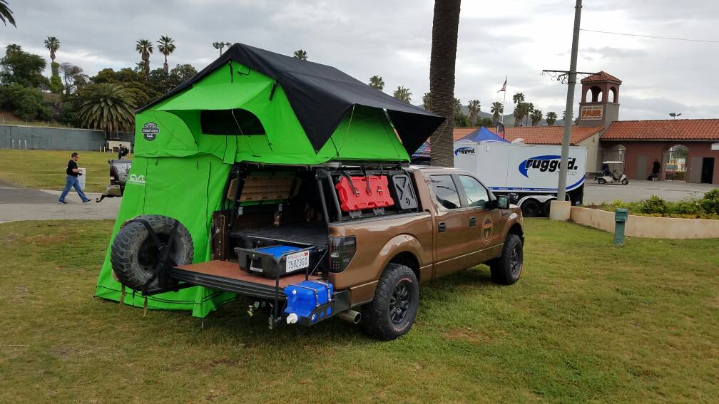

If you decide to go over the bed here is my setup. I'm on version 3 of having a rtt mounted to my bed and so far this new version is the best..... It's a leitner design active cargo system with a cvt summit series tent...

Thanks guys, the Leitner looks great! I just can't justify taking the tonneau off yet. Still looking for suggestions, also weighing the option of keeping the trailer and putting an xsporter rack on it.

Yeah I just spoke with Rhino Rack and they said the only option would be to do a track system (also drilling into the cab obviously). I'd considered putting a rack over the cover, but the tonneau wouldn't accommodate it. Back to the drawing board I suppose for the time being.

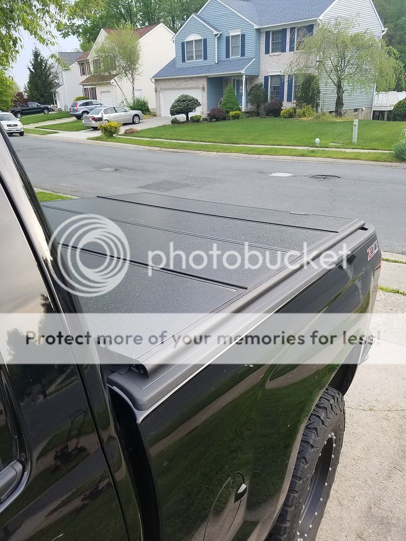

So there is some space on top of the bed rail. You may be able to build or have built a rack that would still allow the tonneau to open. If fab work is not your thing take it to a local OffRoad shop and discuss your needs. Steel is pretty cheap. Labor is what you'll pay for.

Cool, I didn't think it'd be doable without those bedside slots showing- I'll have to find a shop and see what they can rig up! Thanks again for the insight

All comes down to how those bed rail caps are mounted and if your comfortable with someone trimming them a little to make room for some additional structure above. Or maybe the rack could be mounted between the tonneau rail caps and the bed?
disk
I was thinking the latter, sliding between the two- although I suppose if you trimmed enough to access the other hole up front that may work. I still do have this and it might just turn out to be the easier option even with the needed replacements and overhaul.
