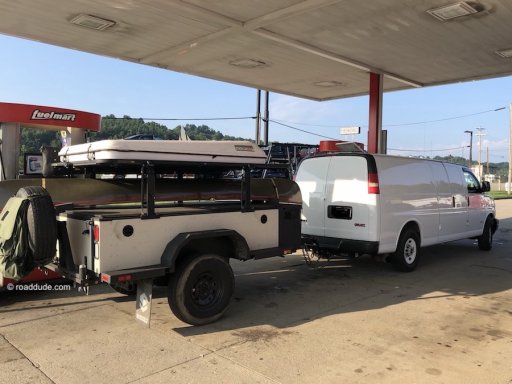

I thought about keeping my 14' canoe (only 28lbs) on top of my RTT on my trailer, but so far have opted to keep it between trailer and rack, as shown below. Keeps it below the van's roofline and out of the windstream going down the highway.
