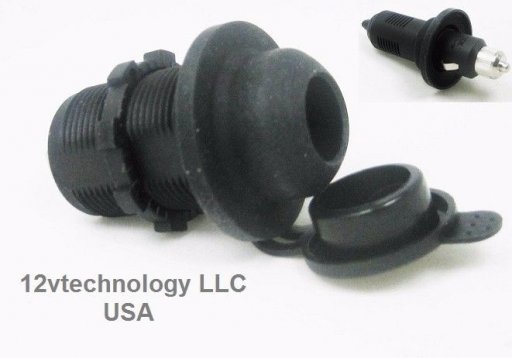

I personally do not like the power supply via the cigarette plug/ socket. Especially not when adapters, e.g. to USB, come into play. The connection is just too wobbly for my demands and need. And that is not only bad with electricity, but also dangerous. I always favor a direct connection (possibly with switch) or a high-quality (and dust and waterproof plug in the places where that makes sense) plug/ socket combination. And of course everything properly fused.

I built a power breakout box that lives in my rooftop tent. The power cord runs to my fuse block in my trailer, through a solar cable gland in the roof of my trailer.
It has 3 cigarette sockets, and 3 dual usb qc sockets. We use it to power two cpaps, and charge two phones and my daughters tablet, as well as run the USB powered light in the rooftop tent. It's worked very well so far.
