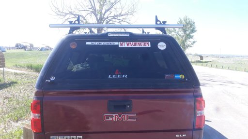

I agree with everyone on the durability of modular racks. I love the fact that they are modular and I can easily add on diffrent mounting. As for the front runners, I have a few friends with them and one of the guys had an issue with the corner trim on his. Its not structural, just cosmetic. If that's a "thing" with the front runners, that could be the bad press their having.
MOAK
2,865
Wernersville Public Library, North Reber Street, Wernersville, PA, USA
Donald
Diehl
0745
WRPN 506
Those are simple load bars: I’m a purist, I think of definition # 1 when referring to something atop a vehicle.

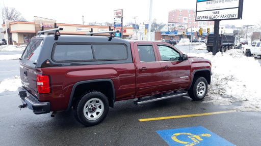

What about an over-shell contractor rack? I didn’t see one mentioned. That way it bolts to the truck bed rails and not the topper nor the cab. That’s what I started with. Then added an expanded metal deck for storage and for hanging solar panels. Contractor racks are definitely strong enough for both static and dynamic loads, can cover the entire truck bumper to bumper and serve a multitude of functions from supporting gear, tents, awnings, recovery gear, etc.

As you've seen, I have a shell on mine, but I think this "over-shell" contractor type is great. Seen it in other threads. A nice shell for dry, safe storage or sleeping, and the contractor rack for kayaks, RTT, spare wheel, or whatever

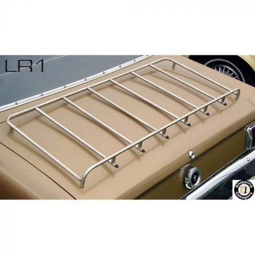

I'm thinking no matter what you drive someone makes a bolt on rack.
Ya might need to adjust yer expectations but the market is soo huge, someone will have a solution.
Thank goodness! There's still hope for my 69 mustang!
Reactions: lhoffm4

Unfortunately that looks like a 65 / 66, and not a fastback. Nice try though! :) I appreciate the try!
smritte
Ontario California
Scott
SMR
8846
KO6BI
Yea, pic was 67. Did a quick search for 69, got racks like that but no good pic.
Funny how things like that were popular on cars long ago. We called them "Luggage Racks" and "Roof Racks". I use to see them literally installed with sheet metal screws.
