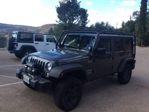

0CD4CCB4-2194-4FD5-B735-05DE18F9BBEA.jpeg I have a smittybilt rack & so far no complaints. Seems pretty heavy duty without the heavy duty price tag it was around $500 from Morris 4x4 center. Just my 2 cents. Good luck. ✌
Reactions: Lazy Turtle
