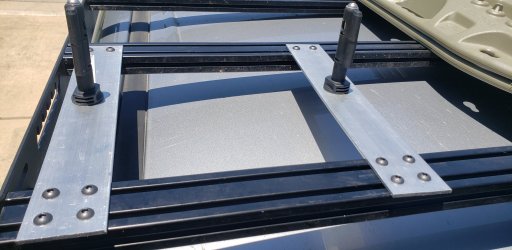

Simple design, but effective., even if a bit crude on the construction. mainly measurement errors resulting in the front set of brackets being a bit short, hence the 2 screws on the one side instead of 4. and while not pictured, the rear brackets having a set of the holes slotted.
I still need to add the cross bar to maintain the side to side distance.

if I decide to keep them as is, I will powder coat them to match the rack, other wise I will remake them. once it cools off a bit
