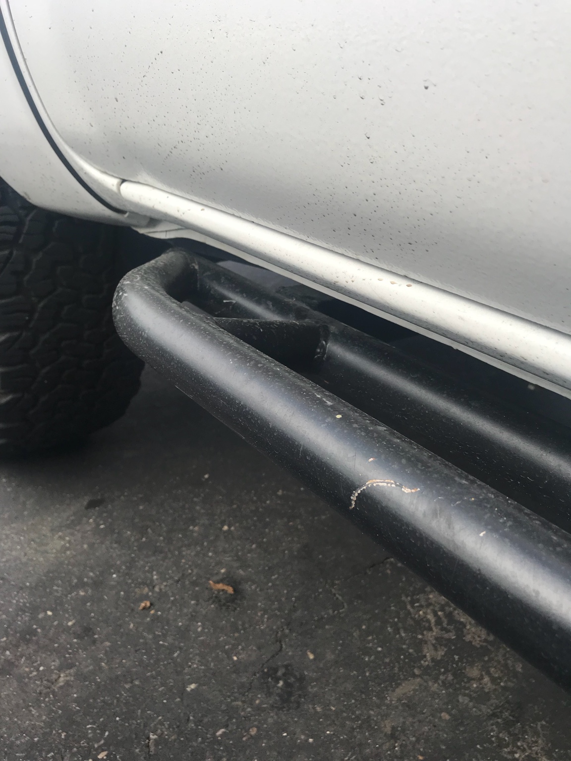

It's the first thing I put on my new Tacoma. My old Landcruiser has a permanent dent below the passenger door and behind the front wheel because the previous owner was driving on his deer lease and dropped off a small "step" that was deeper than he thought. It's not worth fixing but even crappy sliders would have prevented the damage. I bought my sliders from AllPro Off Road and they bolt to the frame. They look great and will support the weight of the vehicle. The way I see it they were about $300 more than my insurance deductible of $500 if I damaged my brand new truck. Most people will probably say to get a lift and new tires first and that's cool but to me sliders come first. I attached an image so you can see how they turned out for me. I'm very happy with them.tacoma-for-web.jpg
