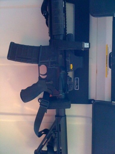

I haven't figured out for sure where, but I will be finding a spot for at least one long gun in the truck or camper. I rarely get to hunt these days, but it would be nice to have the option when I'm out and about.

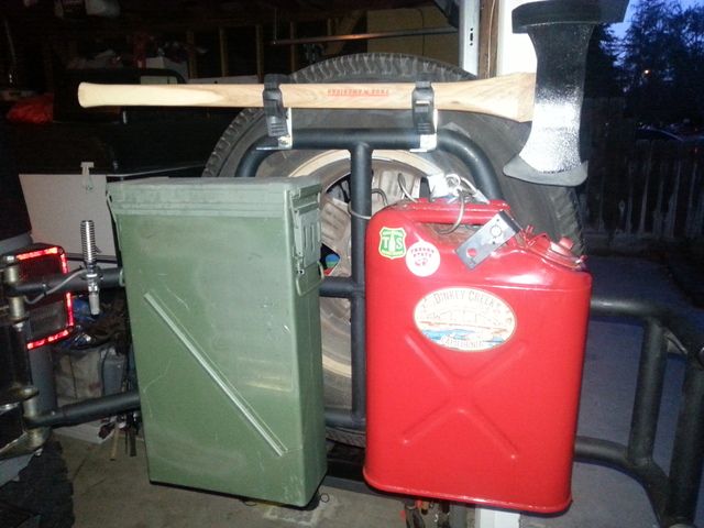

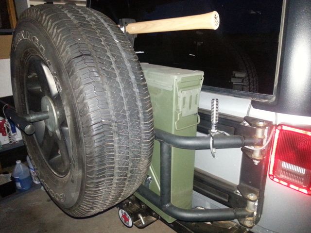

Ammo can-to store recovery gear and parts
Mounted lights
Mounted M249 for crowd control and/or
Mounted tire carrier to hold it all!
I have the OR FAB tire carrier which has been an awesome addition. Sturdy and strong. Unfortunately, OR FAB went out of business recently. Still a great product.

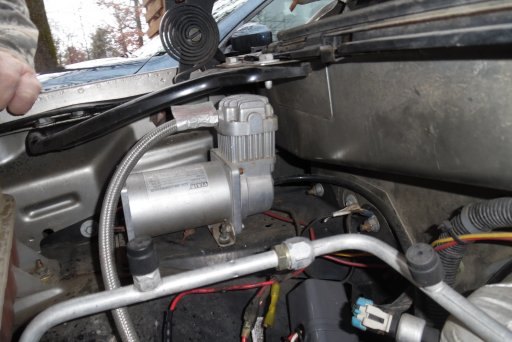

Nothing extreme, it works for me & the wife, I have a single battery under the hood of my 2000 GMC z71, but I went with a large high capacity AGM cranking battery that has fast recovery charge, high output alternator, winch is a 12,000lb mounted on a Warn Trans4mer brush guard w\winch mount, I removed the wire rope for 7\16" x 75ft. Master Pull Classic Synthetic Winch Rope 21,500lbs. breaking strength. The back of the bed of the truck are 2 sets of XBull 10 ton Recovery Boards in carry on cases only when we are out on the trail\dispersed camping. I do have a on-board compressor system w\control panel in the cab, under the hood is the actual compressor & tank is attached on the chassis of the truck, but I have it plumbed only for my air bags only. I do store a portable air compressor system for air'n down & air'n up: VIAIR 400P that is located under the rear seat as well as my first aid bag, tool kit, & rigging bag (items include 4 - 3/4" Shackles, 1 - 2" x 20ft. 20,000lbs. breaking strength Recovery Strap, 1 - 17,000 lbs. Snatch Block, 3"x 6' 30,000 lbs. Tree Saver, 25 ft of 3/8″ Dyneema 18,500lbs. breaking strength extension rope, Trail Gloves his & hers, wireless winch remote, cord winch remote). Next to rigging bag under the towel is Spare \ Extra 7\16" x 50ft. Master Pull Classic Synthetic Winch Rope 21,500lbs. breaking strength.

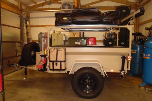

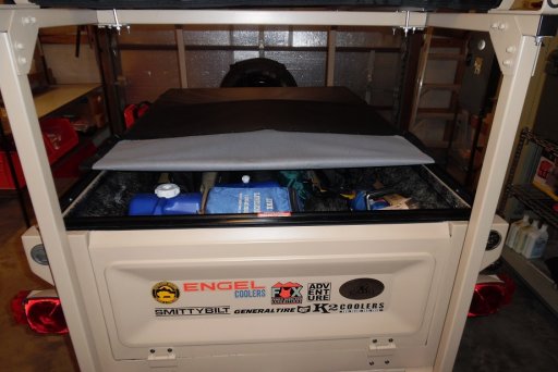

My adventure trailer has 20 gals of stored water, 5lb propane bottle & mount, 42" Bulldog High Lift Jack w\ AUXMART High Lift Jack Mount, Smittybilt Jerry Can mount w\5gal Scepter Fuel Can. I carry a 2 1\2lb Trapper's Axe, Small Recovery T Handle Shovel, & 21" Bow Saw w\extra blades

I sold my 4Runner and am starting over. Honestly the thing I miss most is my hard-mounted and plumbed air compressor. With my 4-into-one air lines, ut was so easy tl inglate and deflate tires thst it is honestly hard to find the motivation to do it the "normal" way.
