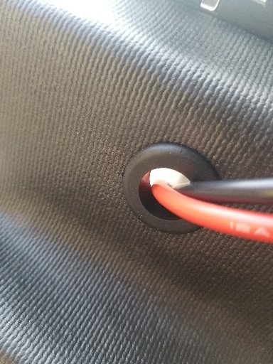

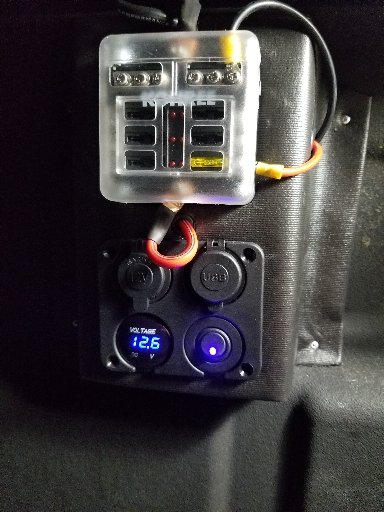

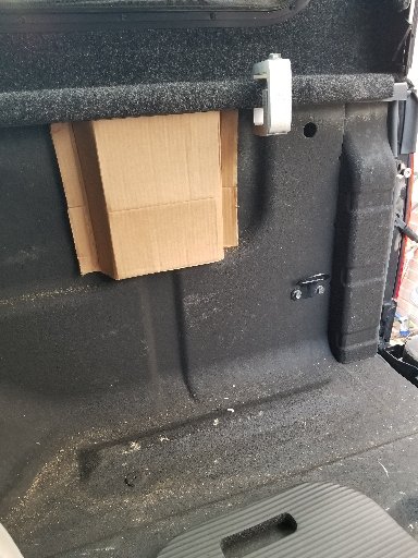

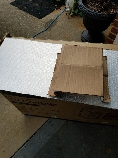

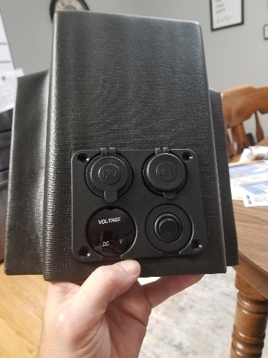

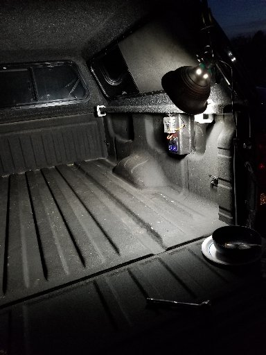

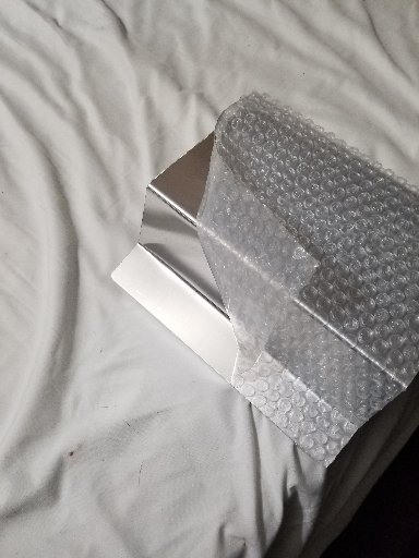

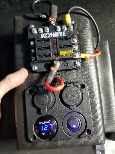

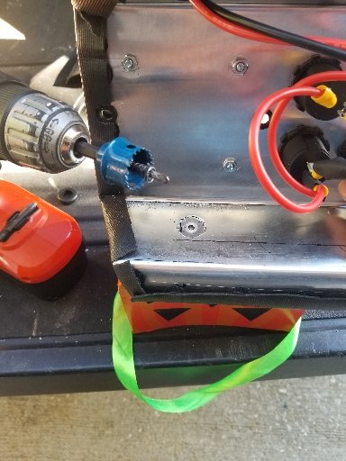

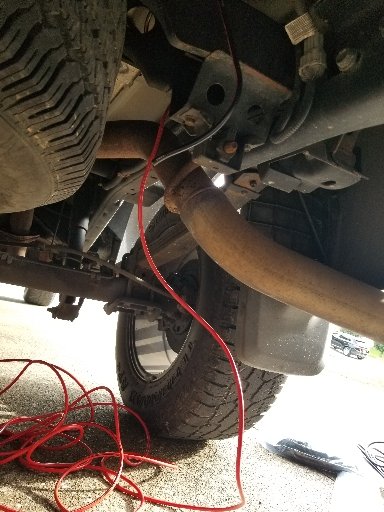

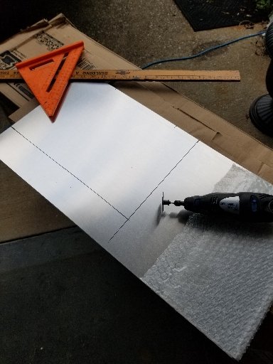

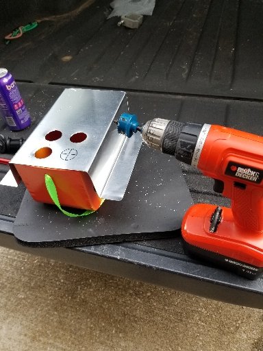

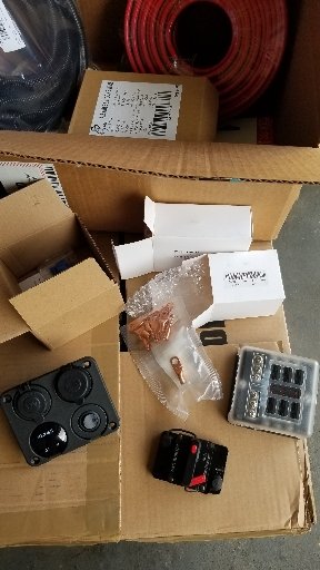

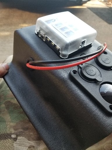

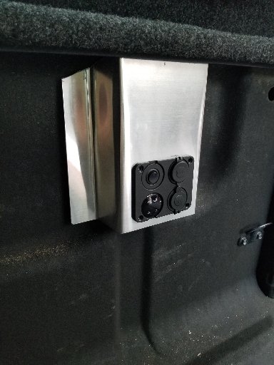

I recently bought a 2010 Titan that I plan on turning into my first overlanding rig. I plan on setting up the bed with the typical sleeping platform with slide-out drawers with stove, drawers, and a fridge. Solar panels will have to come later, but for now I needed 12v in the back to run the fridge. After watching few vids I ordered the parts n got to work, zero experience and all. I got 10gage wire for main line from battery, 40amp breaker, 6 place fuse box, and 4 place 12v panel. I can provide a list of exact parts if anyone wants it. I used cardboard to get the rough shape I needed, then bent thin sheet of aluminum to fit. Covered aluminum with a tool drawer liner.

Nice work! I'm thinking of doing something similar in my Gladiator. I currently only have the ARB power harness running to the back to power the fridge but having other outlets would be nice back there.
