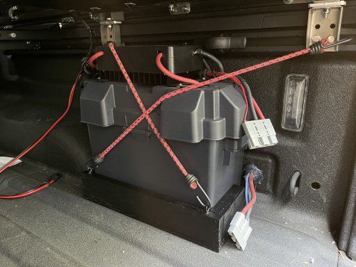

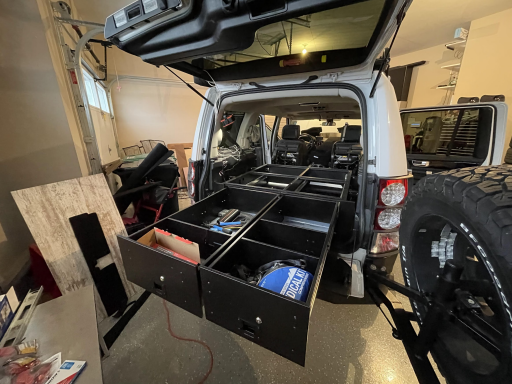

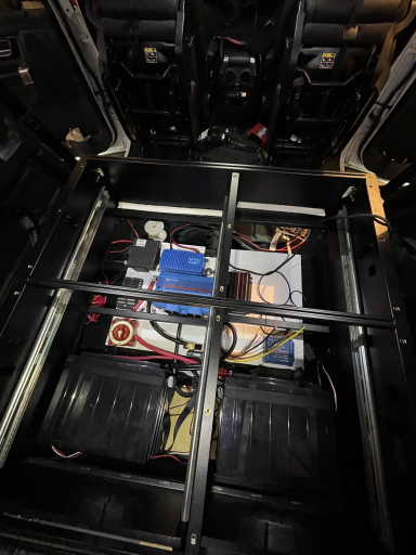

I am in the middle of a full electrical system rebuild. I am using Renogy 170AH 12v LiFePo4 batteries primarily because they happen to be the right size (I have barely enough space to work with under my front runner drawer system with the 3rd row seats removed. The batteries are 6.1" wide, or tall on their side, which work perfectly). I am using Victron for the MPPT, shore power, smart shunt and bus bar. Redarc for the DCDC.
Once I am done you won't even be able to see any of this stuff and it will be in a space that is hard to use for anything else. 4200 Watt hours of power!
