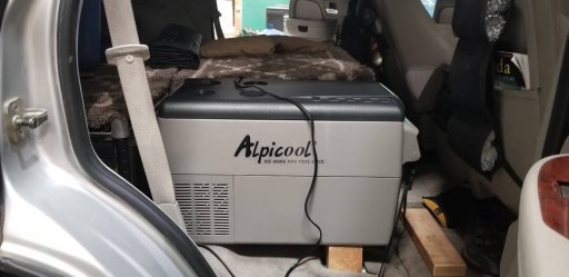

I don't have a Tundra but, I did remove my back seats to install a fridge back there. Main thing to keep in mind would be keep the vents free so it wont over heat. I made my platform the same height as the top of the fridge. I used grated steel shelving for the platform with a layer of carpet on top of them.

YES.. Like that.. Thank you.. what size is your fridge? I'm thinking I'd like about a 35-45 qt but not sure on measurements yet.. Until I remove the rear seat.

I have a Alpicool CF 35 ltr / 37 quart it has worked great for us. We got it a year ago and use it all the time one of our best investments for under $300..

I just noticed I did a typo above it is 35 ltr and 37 qts not 27 qts.
For your set up you might want to go with something that is low because if it is to high and you hit the brakes you might end up with dogs wrapped around your head or them going into the windshield. With a lower platform they will just bounce off the back of the front seats.
We went with the 35ltr because our ice chest we have been using for years was a 35 qt. and we always had enough room in it.. We figured since there would be no ice taking up space it should be plenty big and it has worked fine for us. One thing we do for convenience is put all our food and some drinks in the fridge and we use a smaller ice chest for drinks just behind the center console so they are easier to reach when we are driving. On trips longer than two days in the wilderness by the third day the ice is melted and will be in the fridge..

If you can get a steel shelving unit in there they are easy to build and you can even put a hinge on them if you want to lift them up. Also you can put carpet on top so the dogs will have something to grip into. All you have to do is install the legs pull your measurement and chop off the bottom of the leg to the height you want. I also put a screw or rivet into the leg so it wont fall out when moved around or lifted up. I use plastic plugs from Lowe's for the top of the legs and 1 inch rubber pieces for the bottom. I can do a whole platform in the back of a Tahoe in about an hours time depending on beer breaks... lol My units are held in place by 1 inch tie-down straps to the original seat mounts.

These racks come in a lot of different sizes.. Mine is made out of two shelf units that are 2x4 feet and one unit up front is 2x3 feet.
